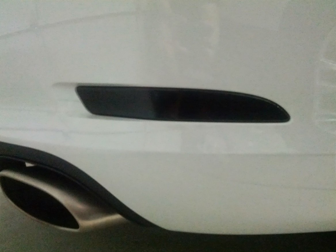

Black Tint Film - $9.95 (I originally wanted the smoked reflector pre-cut kit, but why spend more for more work. I discovered getting an entire roll is cheaper and also easier to install.)

8/15/2013
tint film arrived; followed eBay auction instructions; installed

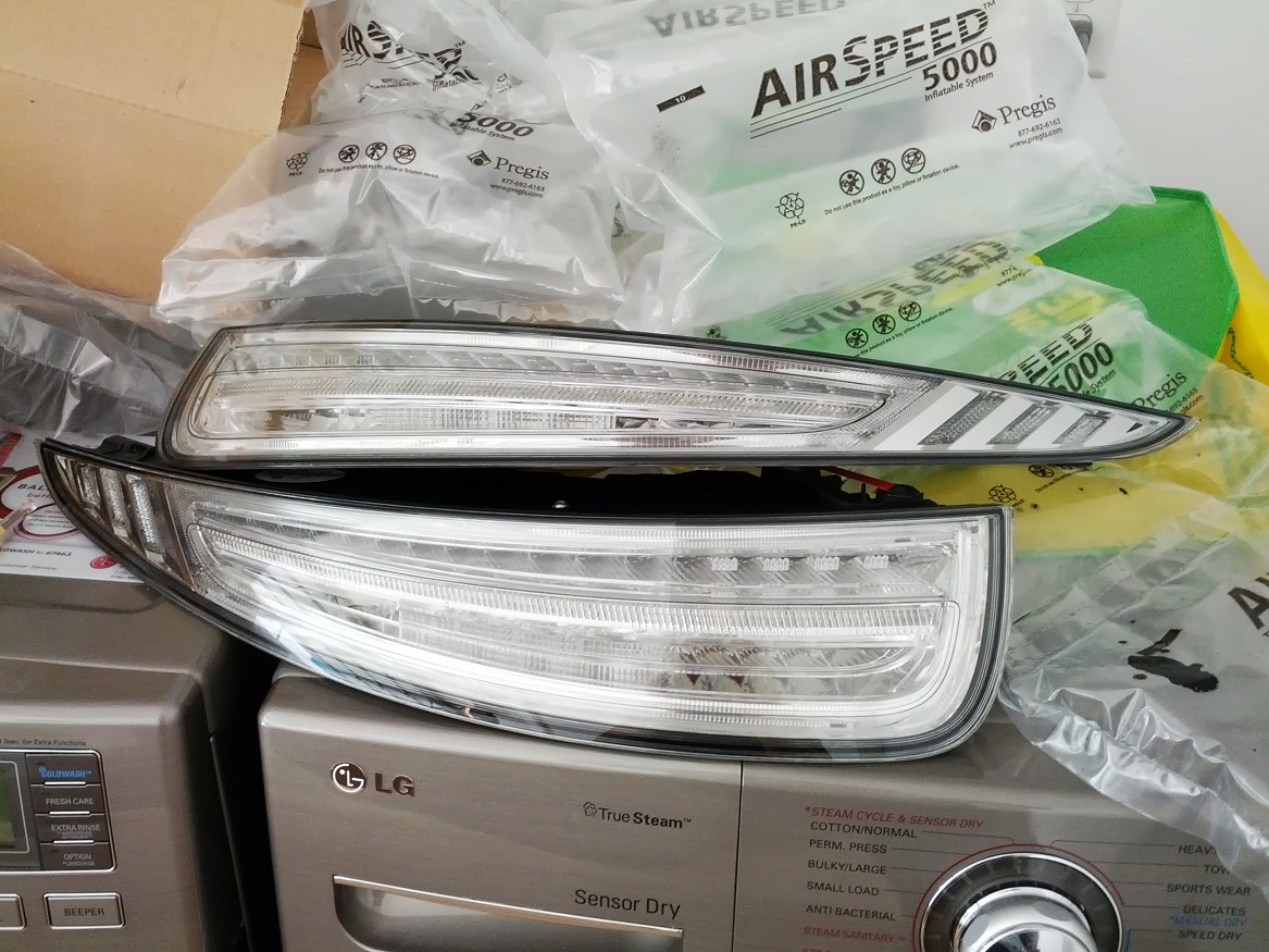

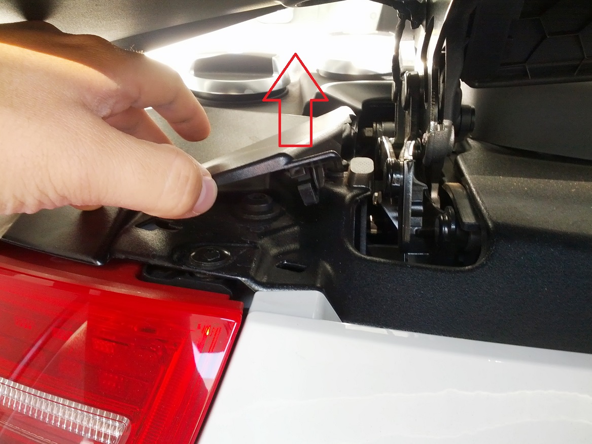

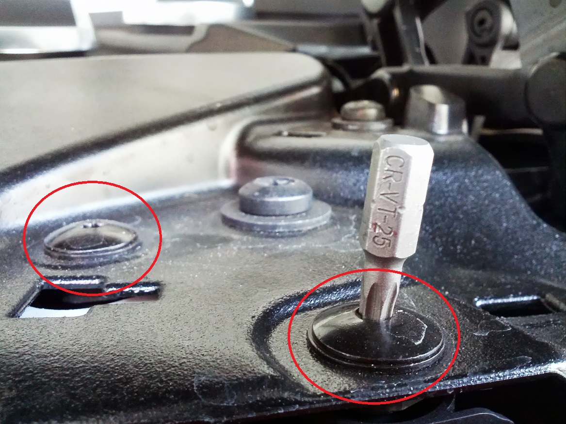

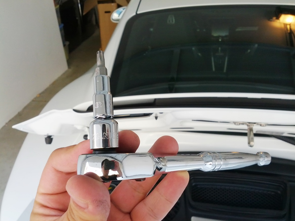

Got my Clear Tail Lights today!
I tried following this post for the installation. It didn't help me @_@. So here is my 991 Clear Tail Light Installation DIY ...it worked for me:
Unboxed the Tail Lights

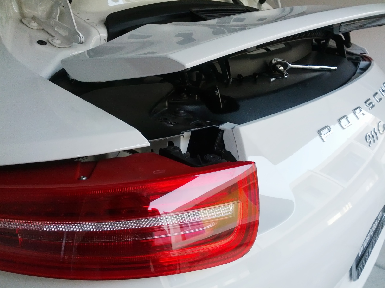

Raise the Rear Spoiler. Pop up The Cap with a Flathead. Do the same for the right side.
You Will Need a T25 to Unscrew These Two TorX Screws
Not Enough Room for Regular ScrewDriver so I Assembled This Wrench Tool - It Did the Job

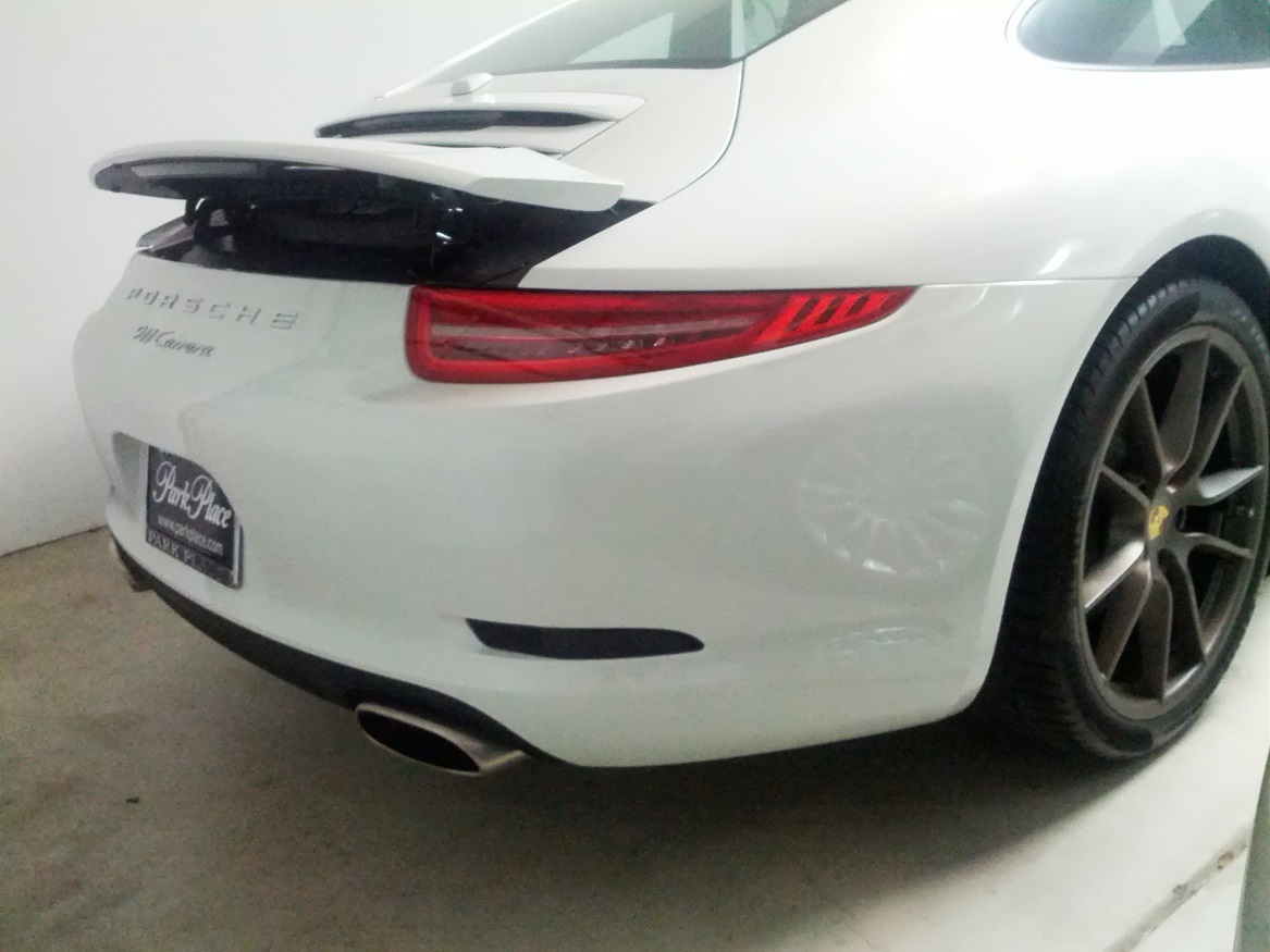

After You Unscrew Both Bolts, Just Pull Tail Light Towards You and It Comes Right Off
Repeat Process for Right Tail Light
All Set!

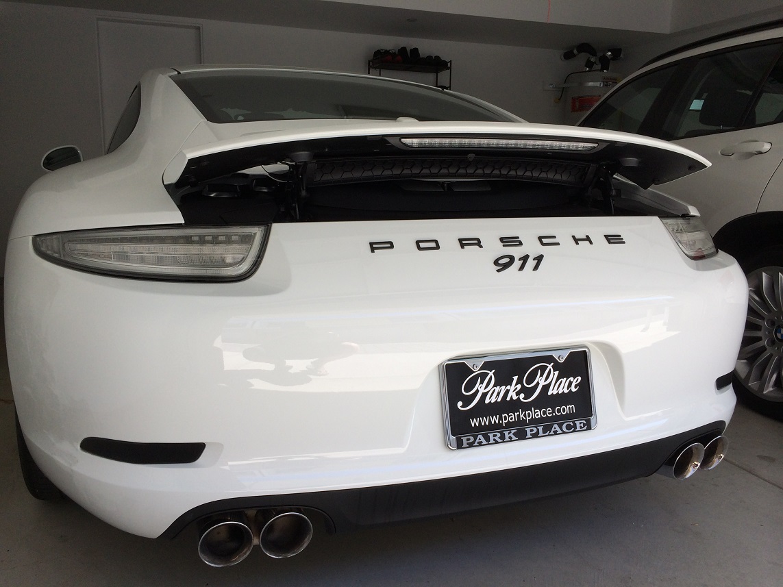

8/22/2013 - Polished Quad Tips ordered from Fabspeed. Got the best price direct from David@Fabspeed.
9/06/2013
Got my Fabspeed polished tips.
To take off my 991 stock tips, I used an E12 reverse torx socket. You can get a set here:
Amazon.com: Anytime Tools 11 pc FEMALE E-TORX (Star) SOCKET Set w/RAIL E4 - E20: Home & Kitchen Amazon.com: Anytime Tools 11 pc FEMALE E-TORX (Star) SOCKET Set w/RAIL E4 - E20: Home & Kitchen
Alternatively:
Originally Posted by Compukidd
You could have used a 10mm 6 point wrench to remove the 991 stock tip. You didnt have to spend the $ on the torx set. The Fabspeed tips use a 13mm wrench. I'm sure you know that part now. All the best!
Here's the result:

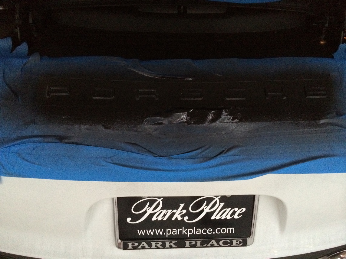

10/13/2013
Saw Brooklyn991's thread here
Home Depot
Plastidip - $5.95 + tax
Painters Tape - $3.50 or something
eBay 911 Badge - waited for my eBay bucks to kick in and got this one from the UK because the other one in the U.S.had numbers individually taped so I'd had to line it up manually. Also the UK is cheaper.
All Set!
