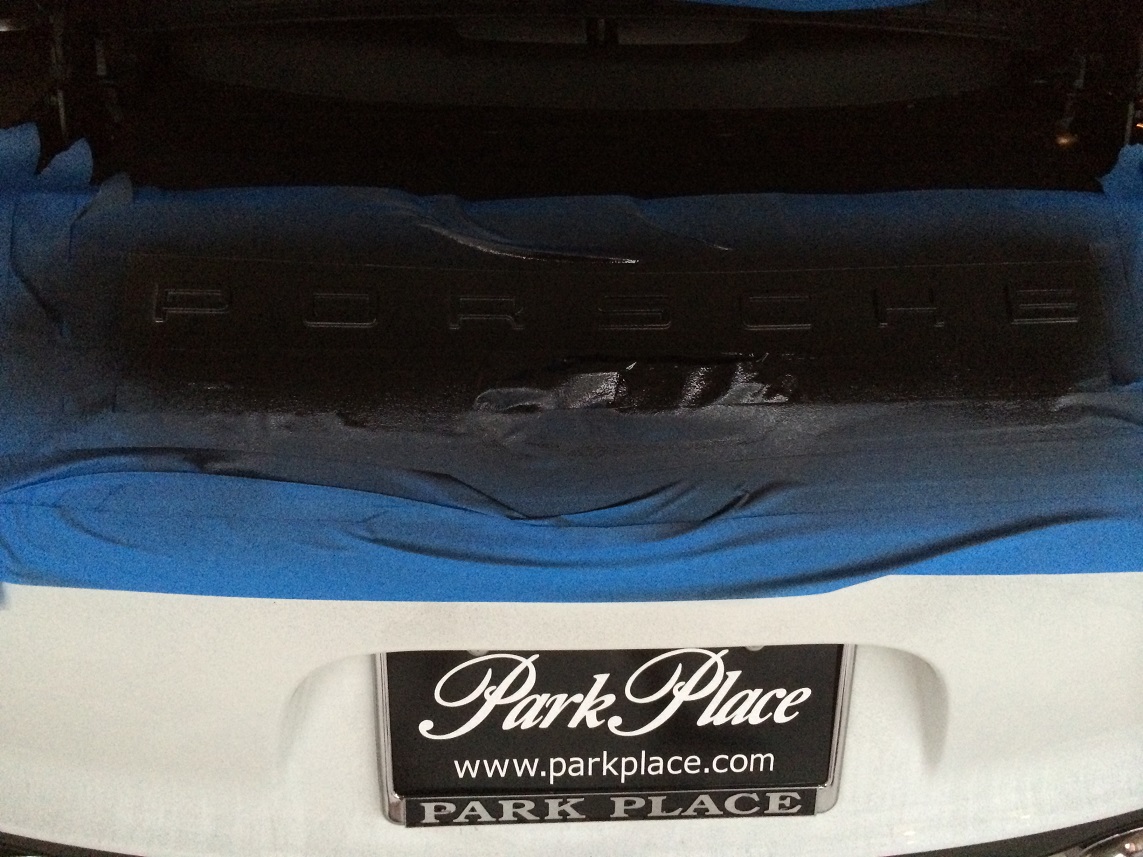

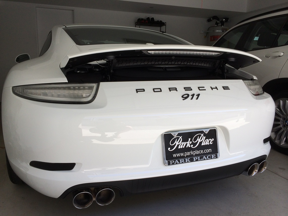

10/13/2013
Saw Brooklyn991's thread here
Home Depot
Plastidip - $5.95 + tax
Painters Tape - $3.50 or something
eBay 911 Badge - waited for my eBay bucks to kick in and got this one from the UK because the other one in the U.S.had numbers individually taped so I'd had to line it up manually. Also the UK is cheaper.

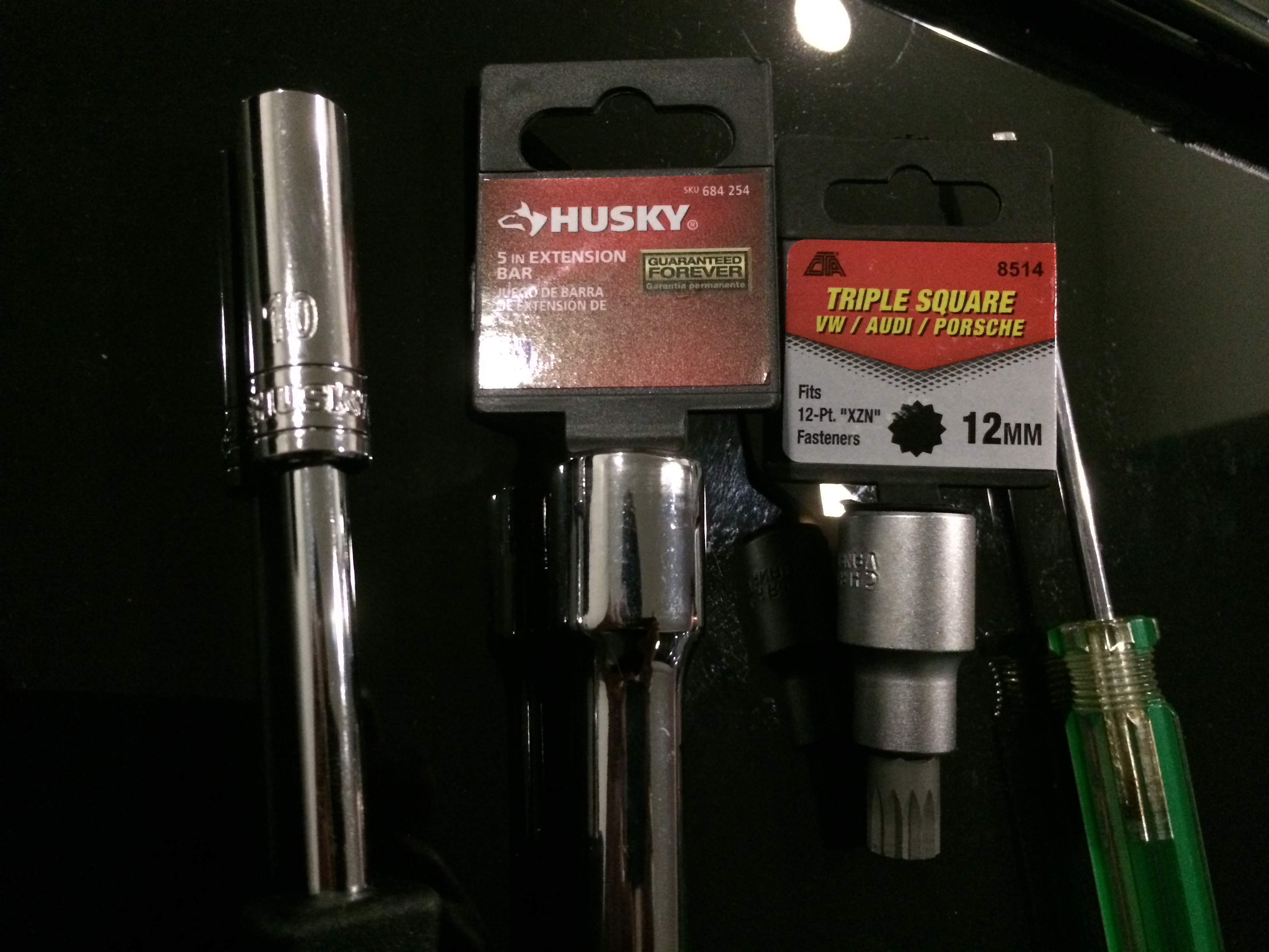

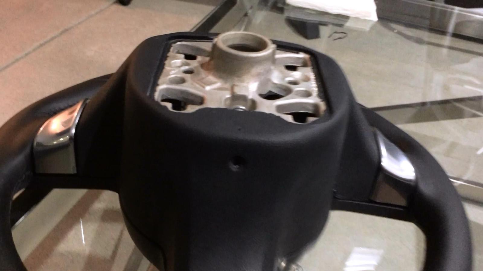

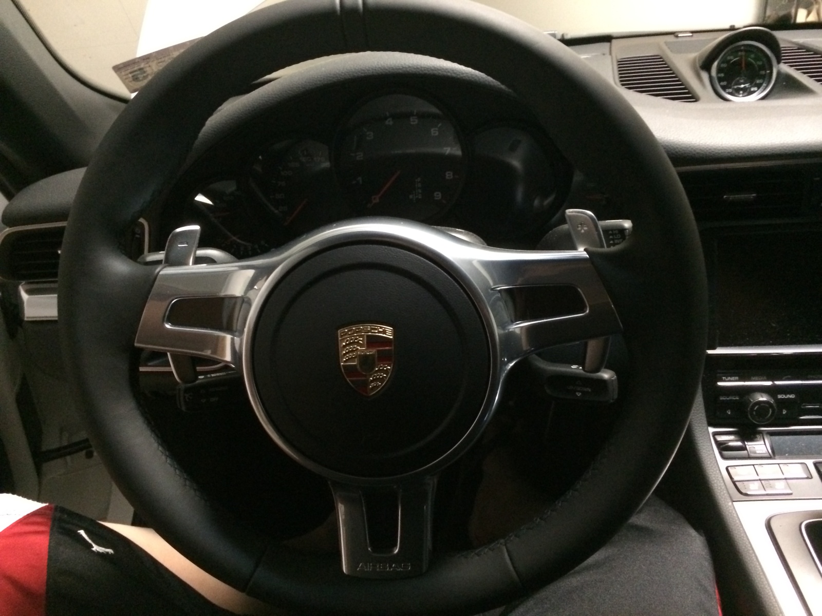

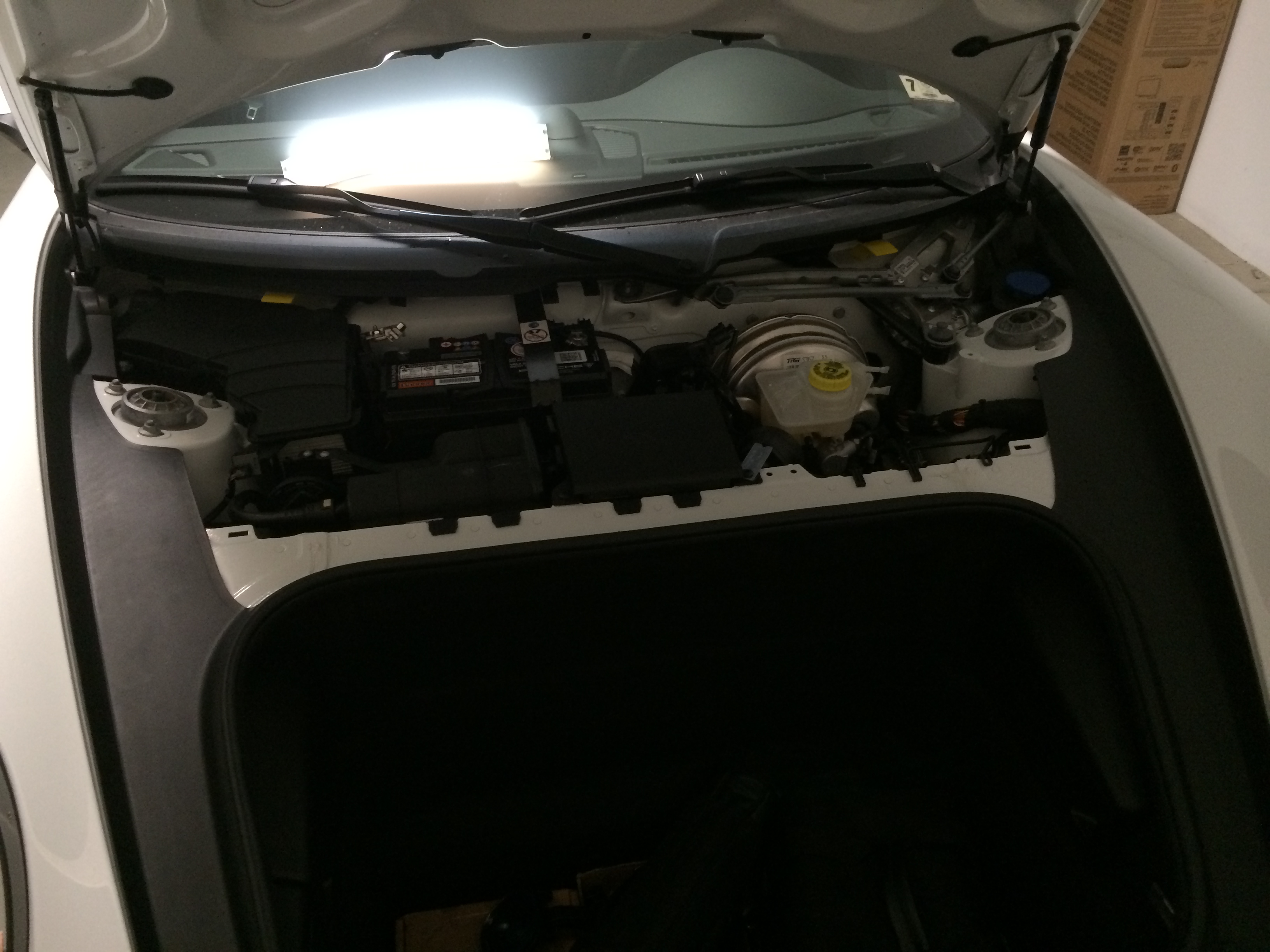

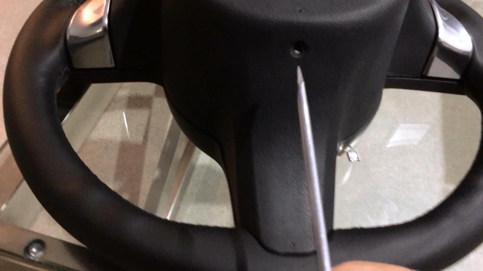

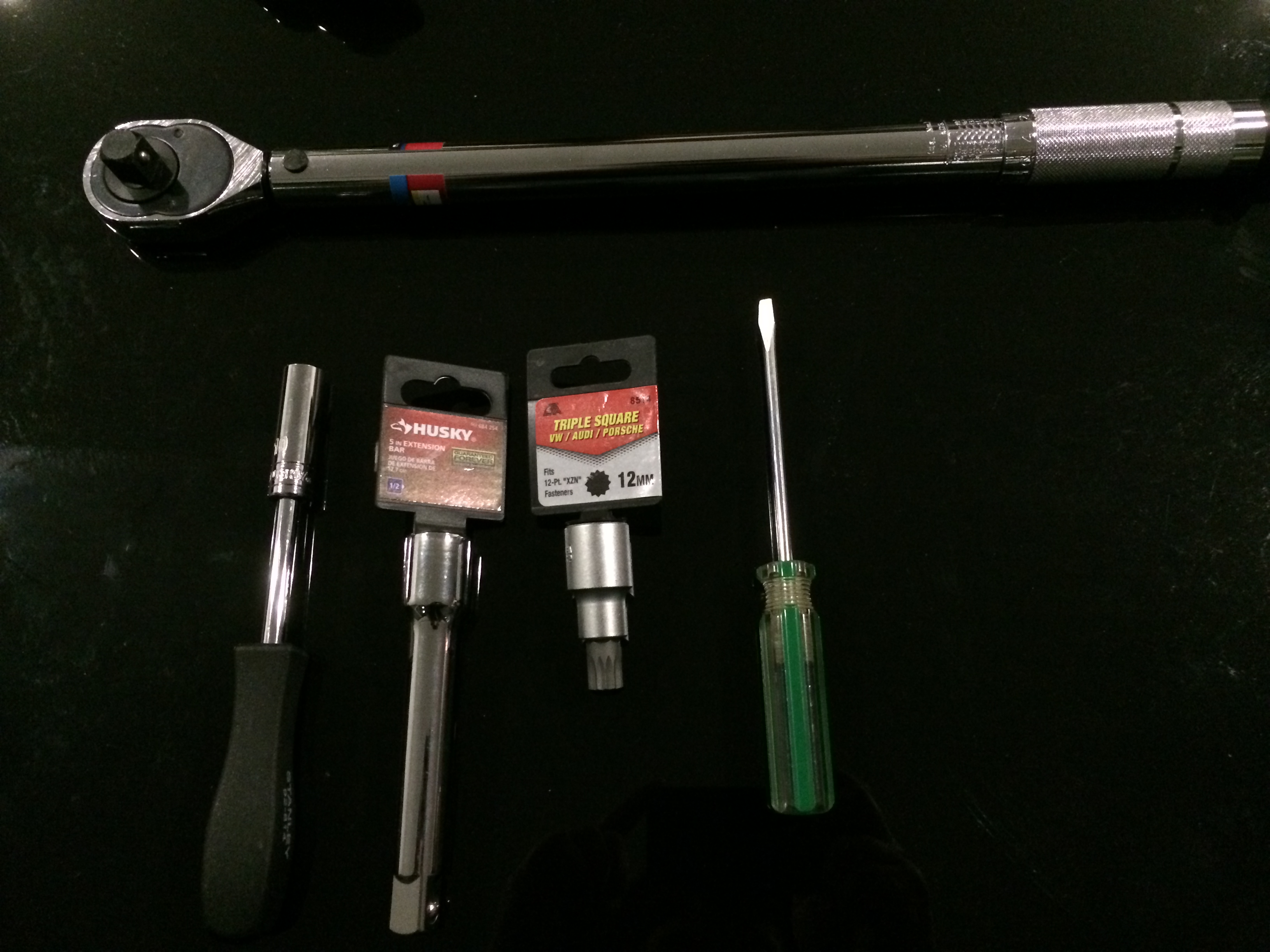

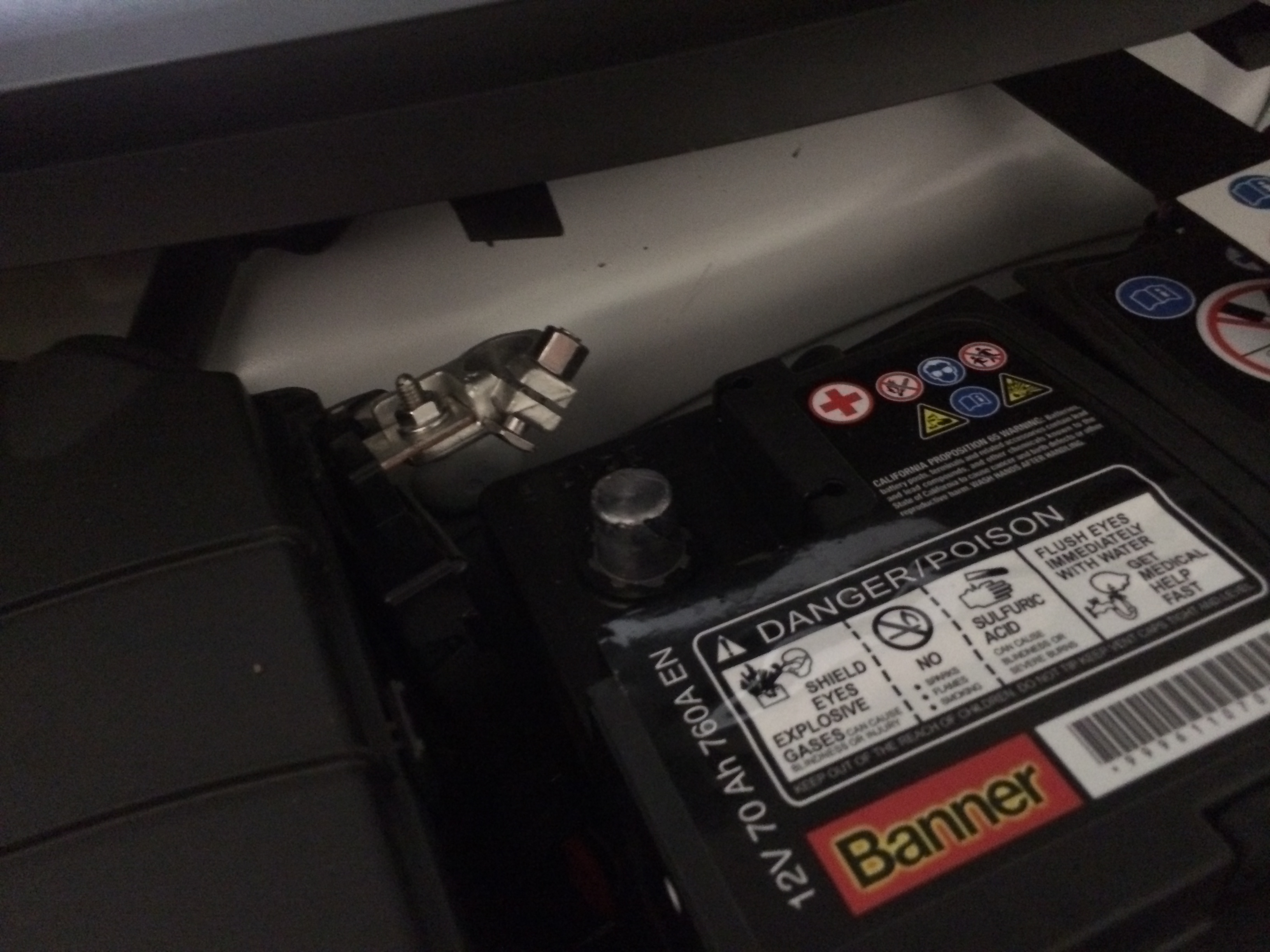

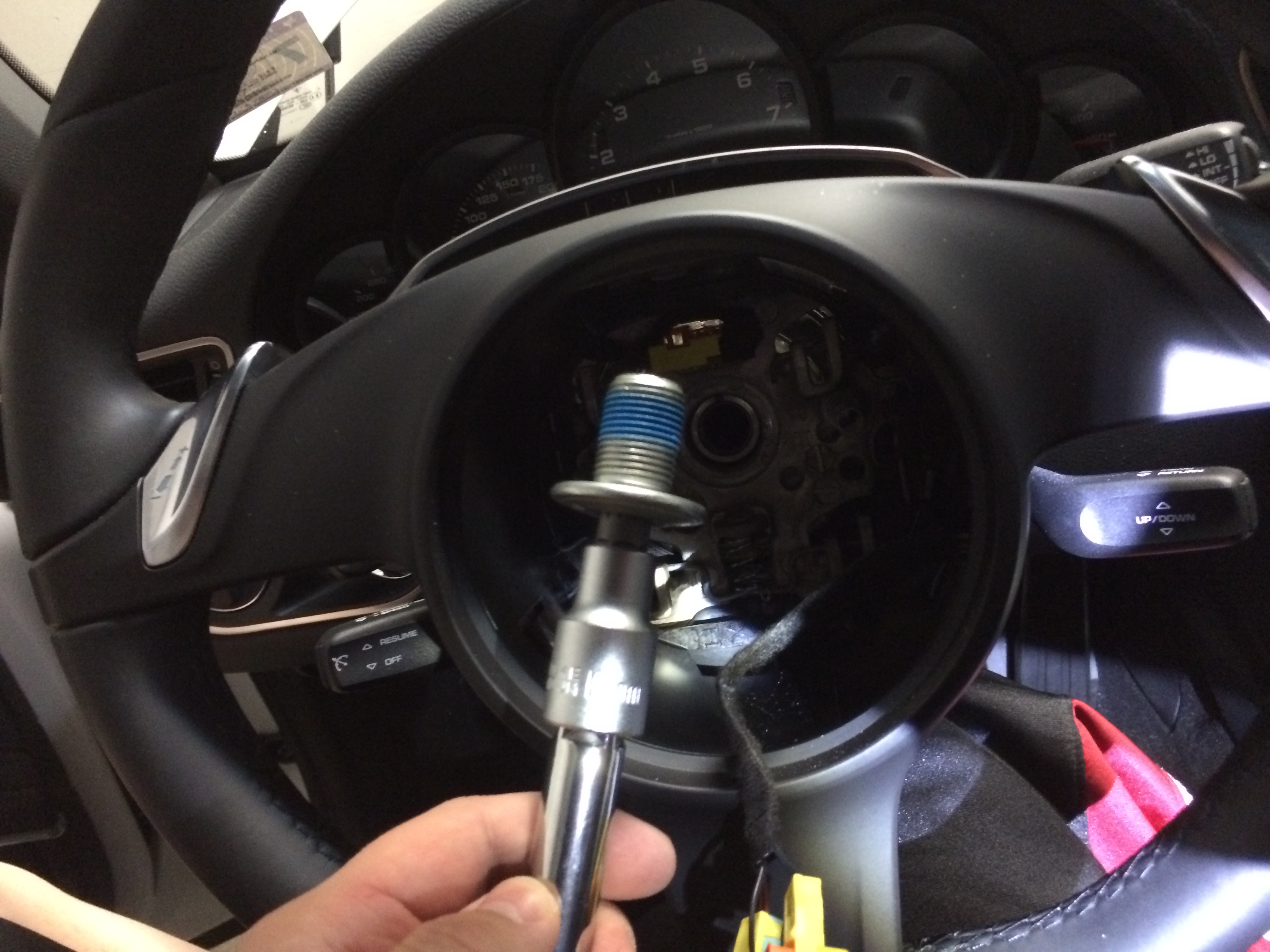

Got my steering wheel today.
You will need:
  1. Thin Flathead
  2. 10mm Socket
  3. 12 Point Triple Square Socket Bit 12mm (I got a 1/2" drive)
  4. Drive Ratchet + 5" Extension Bar for Ratchet (mine was 1/2")
Steps:
  1. Pop your frunk.
  2. Remove the frunk liner.
  3. Battery is exposed now.
  4. Use 10mm to disconnect battery.
  5. Pop airbag through hole on the bottom.
  6. Make sure to position to flat head as shown and just push it straight up.
  7. Airbag will pop out very easily.
  8. Disconnect airbag from wheel.
  9. Use 12point 12mm to unscrew bolt.
  10. Pull steering wheel off.
  11. Put new steering wheel on.
done...

Anyway, noob question: I currently have the "911 Carrera" badge as well and want to just stick with the "911" as you did with yours. Did you debadge using the usual floss method? I haven't debadged a car since my RSX more than a decade ago lol. Did the replacement emblem come with double sided tape already?
Old Dec 23, 2013 | 06:34 PM
  #45
genpop3's Avatar
Joined: Jul 2013
Posts: 88
genpop3 is just really nicegenpop3 is just really nicegenpop3 is just really nicegenpop3 is just really nicegenpop3 is just really nice
Originally Posted by kobett
Car looks great! Were you on E90post? Your username looks familiar...I just switched over from an M3 too (2swift).
2swift29? Kenny??
yessir I was on e90post (I'm on there as AoshichanX & jasonn)
I debadged with floss and goo gone. It was a b*tch to get off so I recommend doing it asap before the adhesive sets in any further.
My replacement emblem came with double sided tape. I recommend getting the one from the UK as it is lined up already on one strip. Just rip off half the strip, position, then rip off the other half as you put it on. Can't find it on eBay anymore though hrmm.
Anyway it was exactly like this one: http://www.ebay.com/itm/Porsche-911-...4fa179&vxp=mtr
except it was $27.
For this one: http://www.ebay.com/itm/PORSCHE-911-...651cb9&vxp=mtr
they send you the numbers separately.
EDIT: found the UK link (not sure if still selling)
http://www.ebay.com/itm/171120842689...84.m1497.l2649
