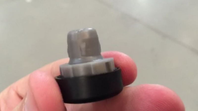

Kickdown eliminator
I have been driving my 991S on the street and decided that I really don't like the kickdown when in manual mode. And I don't think I would miss it in auto mode. So being a mechanical engineer I decided to make a kickdown eliminator. It will be the same size as the OEM button but will not collapse when pressed. So the driver will be able to push the accelerator pedal hard to the floor without causing a downshift. The good thing is that the button is very easy to remove or replace if it was desired to go back to stock. My question is how many people would be interested in this? And what price would you be willing to pay?
As I said I am building a prototype now to verify dimensions and should be ready to place an order next week.
Let me know if interested.

I have been driving with the kickdown eliminator for a while now. I like it, don't see any downside to it. In auto mode it still downshifts if you floor it. For example if I am driving along at 55 mph in 6th or 7th and put the pedal to the floor, it downshifts to 3rd. It"might" take a fraction of a second longer than with the kickdown but I see very little difference.

Does this Disable Launch Control?

Eldertech - Does launch control work if you push the pedal until it just contacts the kickdown switch (but does not depress it)? If so, then the kickdown eliminator would not change anything.
No it doesn't
