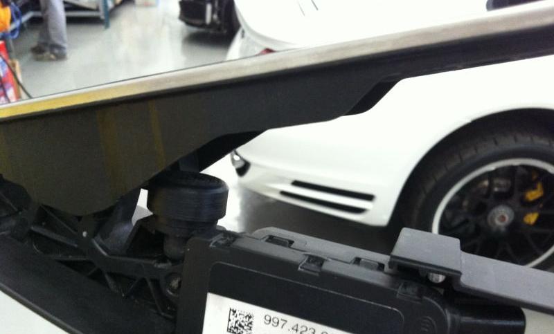

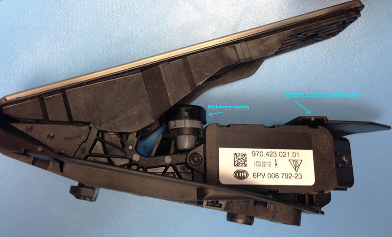

PDK, disabling automatic upshifting in M mode (disable kickdown switch)
Hi all,
I am racing driver and during the last seven years I have participated in all racetrack events of the Porsche Club of Brazil (and others private track days), always driving Porsches with manual gearbox.
Recently I bought a 997.2 Carrera S PDK to drive in manual mode, but I did not like the PDK system shifiting gears up automatically, especially in the middle of corners, leaving the car without traction.
With a simple change in the accelerador control the car is now improved for track days (only upshifting).
I removed the original kickdown switch and installed a fixed hand made part, with exactly the same measures of original piece.
The electronic pedal remains the full throttle, but stops before sending the signal to upshifiting.
Now I can control the gearbox to use all 8K rpm of engine, using the paddle shifters steering wheel.
The system is similar the new 991 GT3 PDK-S without kickdown, and can to be installed in any model Porsche PDK.
I hope you enjoy.

Sound like he disabled the kickdown button by removing it and replacing with a dummy that is the same dimension that allows full throttle without a unwanted downshift, really a simple solution.

Upshift (+) or downshift (-) depends the car speed. If you are driving slowly and accelerate quickly to the bottom and click the kickdown, automatically downshifit two or three gears to increase speed, regardless the RPM engine. In the other case, driving fast, the upshifting prevents exceeding the limit of revolution engine RPM.
I am engineer and developed this piece to solve a problem: drive with PDK in M mode on circuits. The original system when reaches the rev limit, automatically changes gear up. I noticed that is a world claim about PDK in track days.
Initially I did not think to sell this piece. It takes only two or three minutes to change on accelerator control. I believe that should be used by experienced drivers, who are accustomed with manual gearbox, to prevent the engine exceeds the RPM limit in manual mode.

[QUOTE=991C4s;4293690]This is what I did on my 335 just used double side tape
I thought about that, but the heat is high into the car on a circuit. The 'stop' can lose the glue and the driver does not see.
