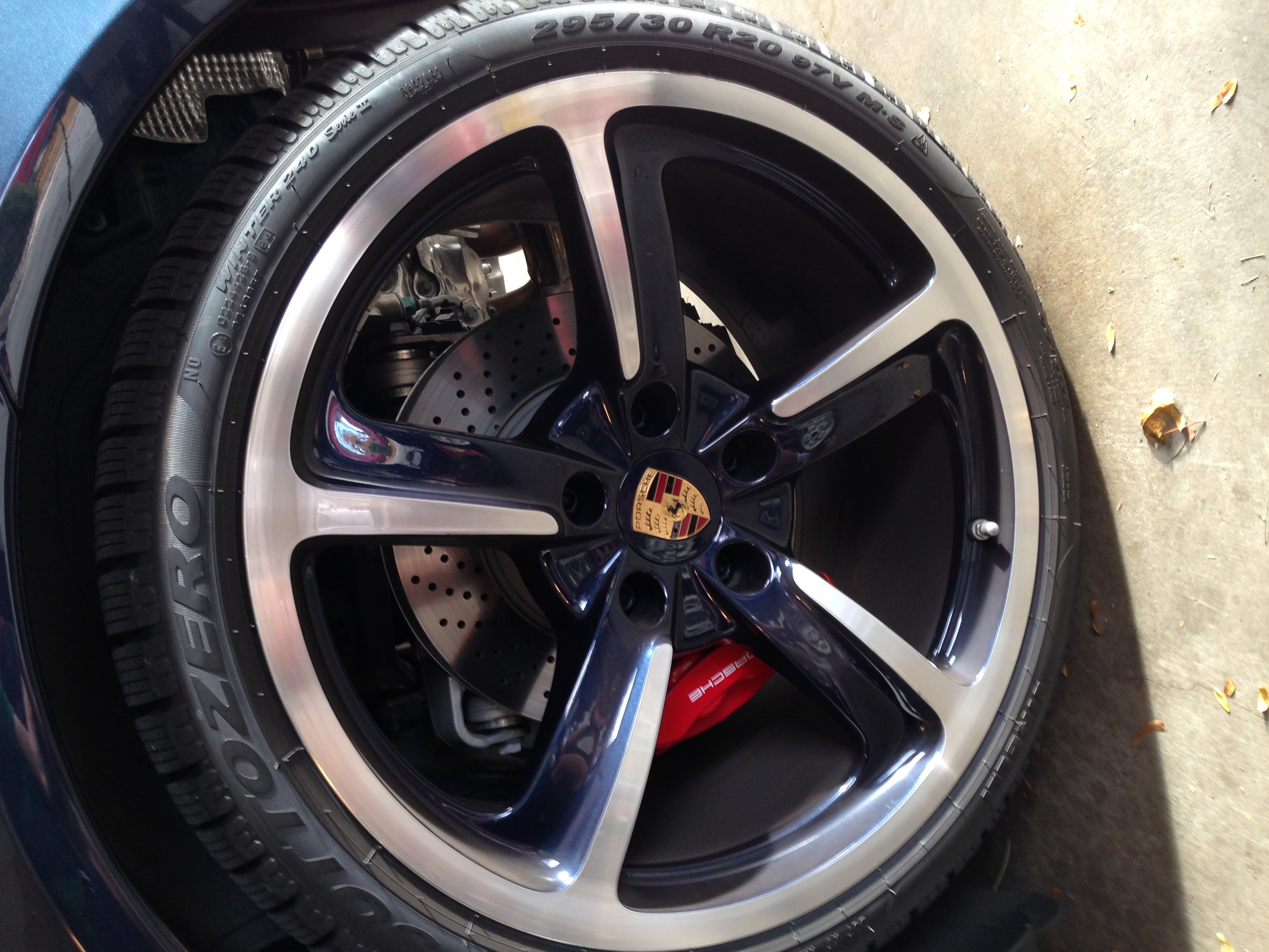

I decided to drive the Sport Technos year-round with the Sottozeros in 295/30 on the rears. I've included a pic so you can see it is indeed possible. They were bought from and mounted by my Pcar dealer.
Name:	Sport Techno with Sottozero.JPG
