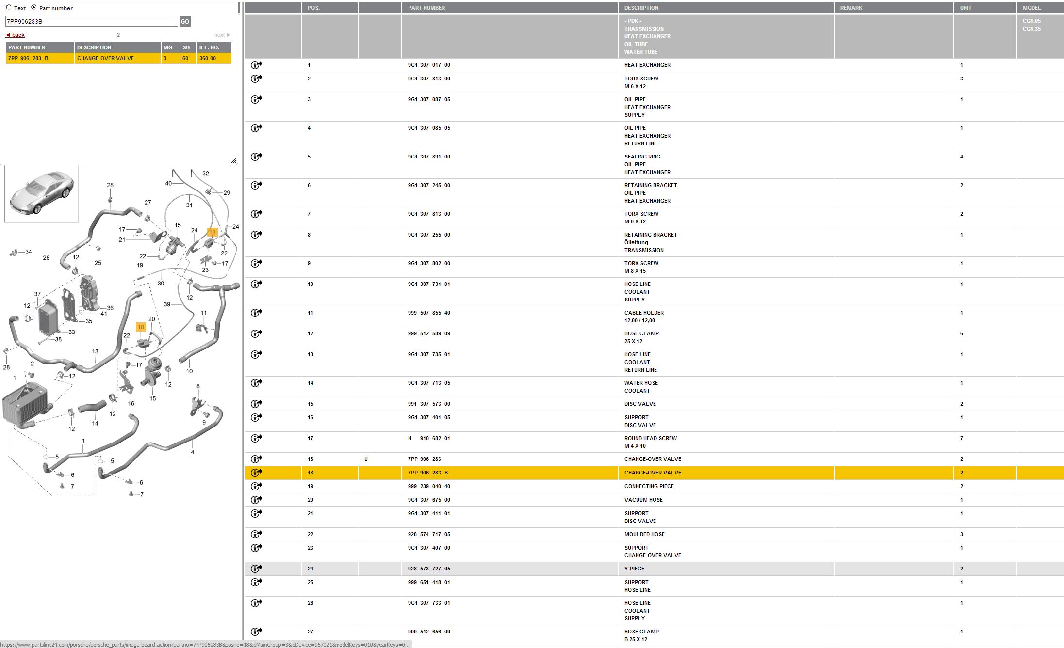

PDK Diagram

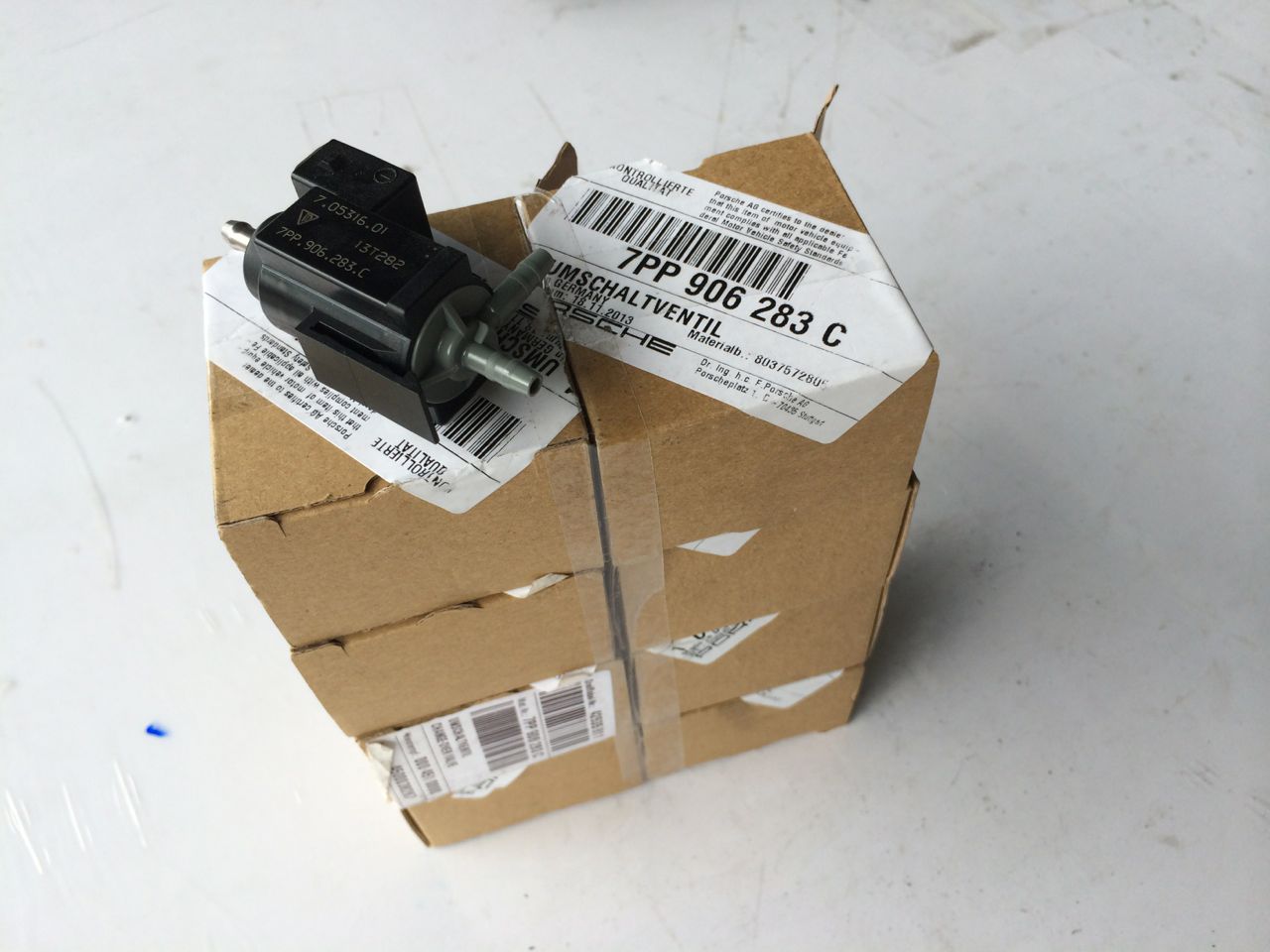

Hi,
My car is 2012 so I asked my indy shop to change 8 of them. It is a fairly easy job and it would take about 1-1.30 hour for a good mechanic to do it.
We found 3 units out of 8 units were defected.
- PSE Exhaust (make no sport sound)
- Sound Symposer
- Air cleaner box flap
You can see that the new change over valve "rev.C" is in black and the old one "rev.B" is in grey.
You need to remove the bumper and spoiler to get access these valves. The two for PDK is underneath the car and it is easy to change.
ID:	342085   Click image for larger version
