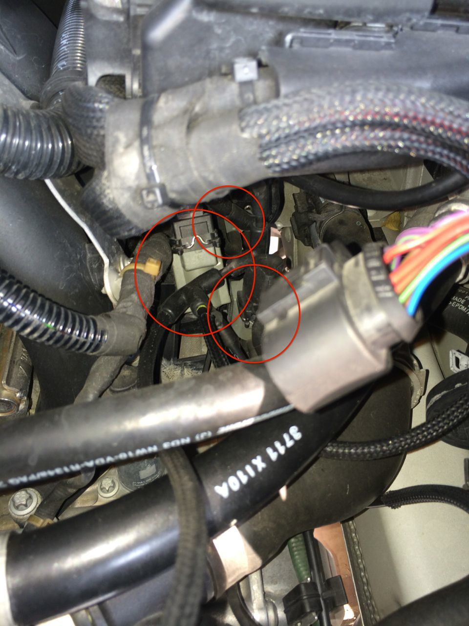

2 units are at the intake box, it is very easy to change.
I believe these two are; sound symposer and air cleaner box flap.

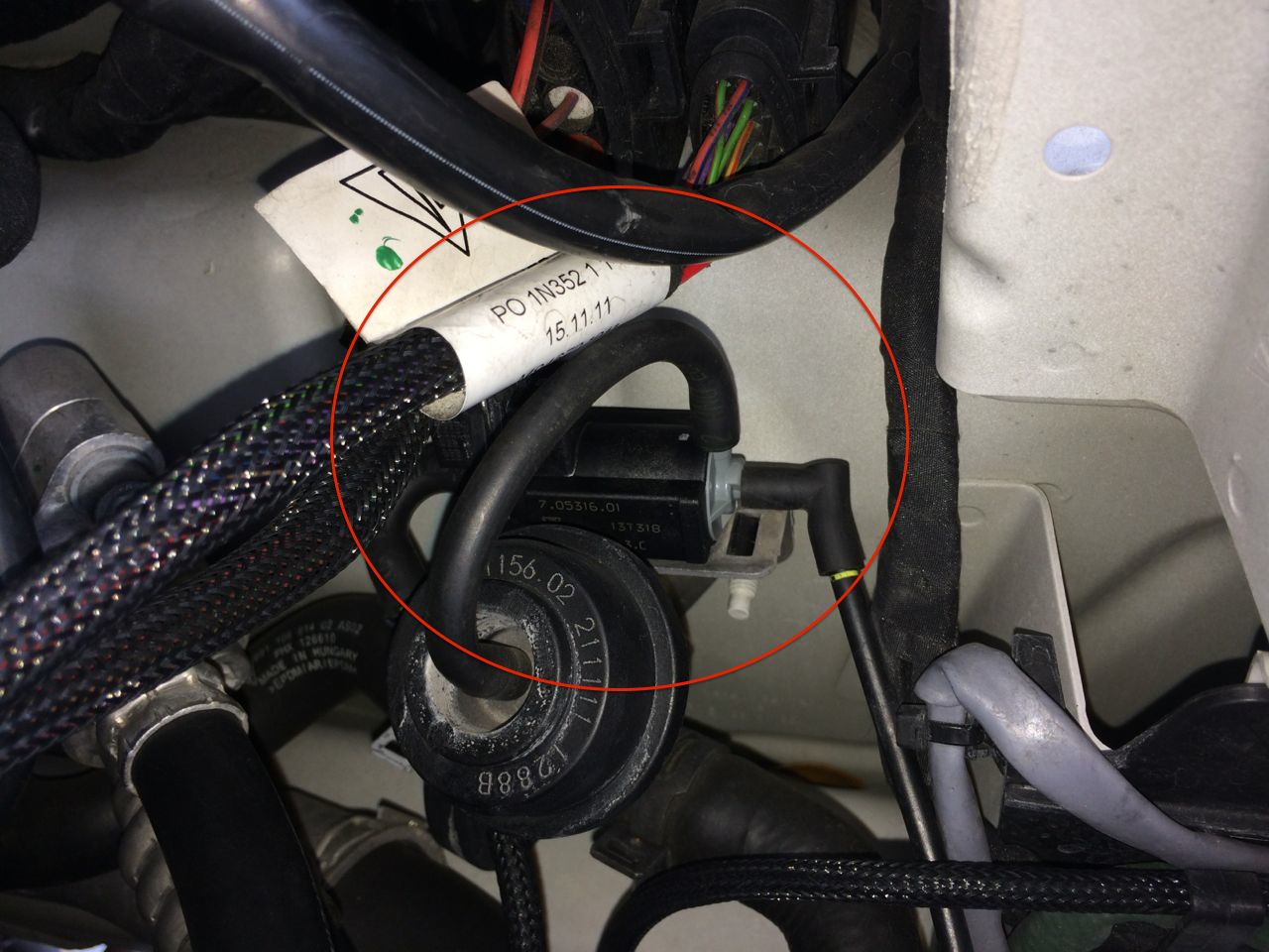

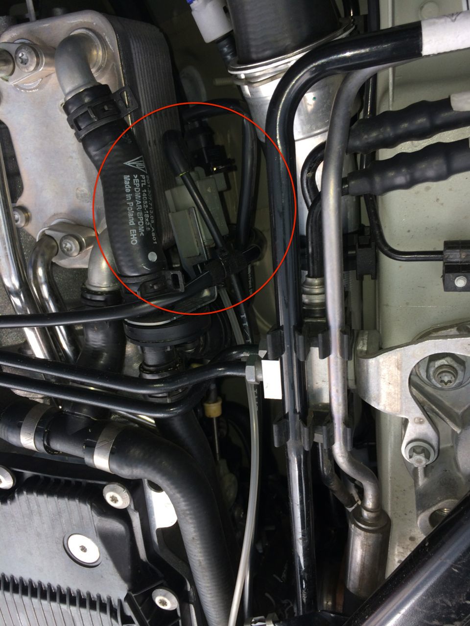

Another one is located at the far right in the engine bay, this is for water tube & heater.

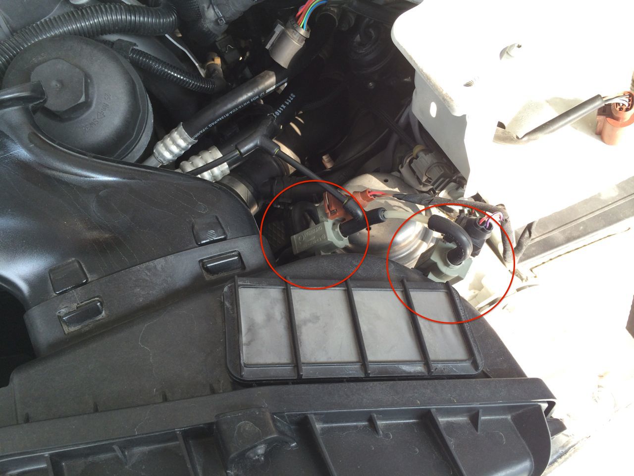

3 units are located in the same area, it is quite difficult to see but it is changeable by hand.
- PSE Exhaust
- Tuning flap
- Engine coolant

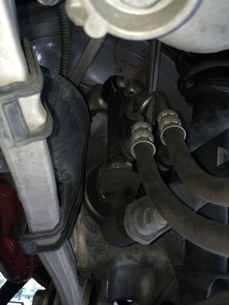

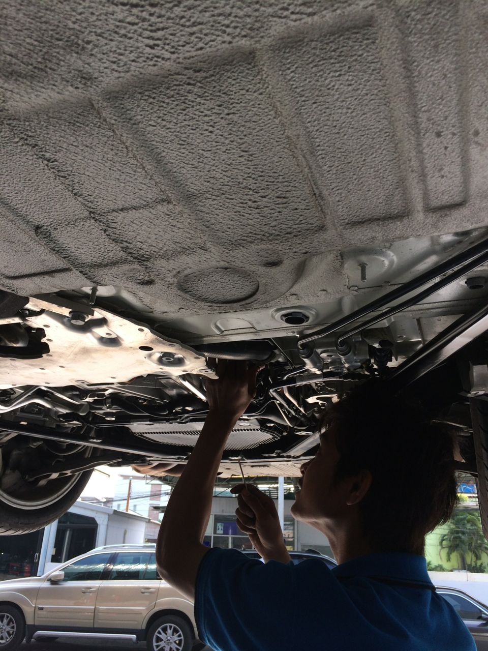

Then for PDK, these two are the most critical.
You need to lift the car up and remove the protection tray underneath the car, you can see the PDK and you will easily find these two change over valves. Again, pretty easy to change.
ID:	342099   Click image for larger version

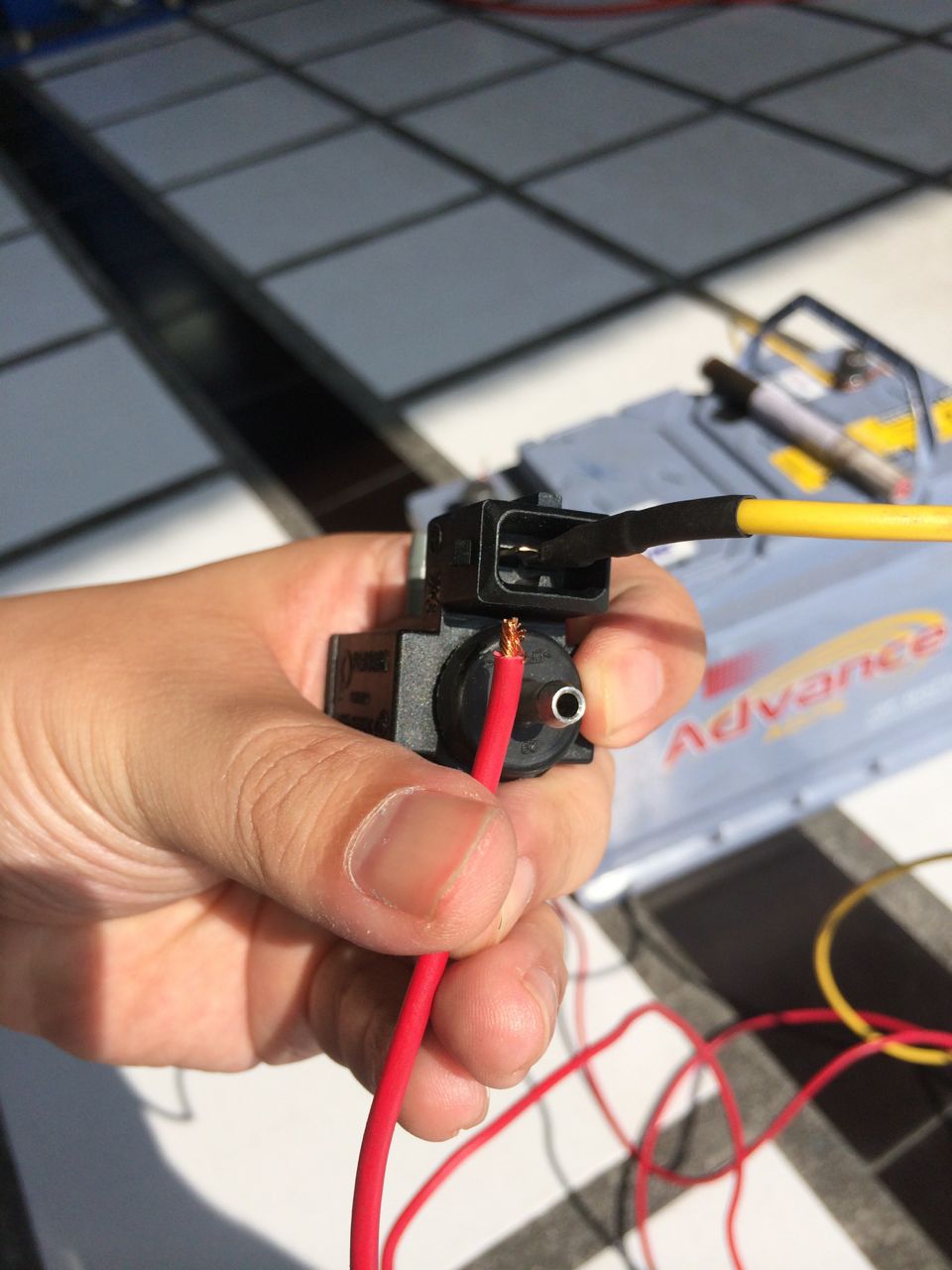

It is recommend that you should check if the new one is working properly.
This is easy to check by connecting it with 12V battery then you should hear the sound as well as a little vibration.
You will not hear or feel anything from the bad one

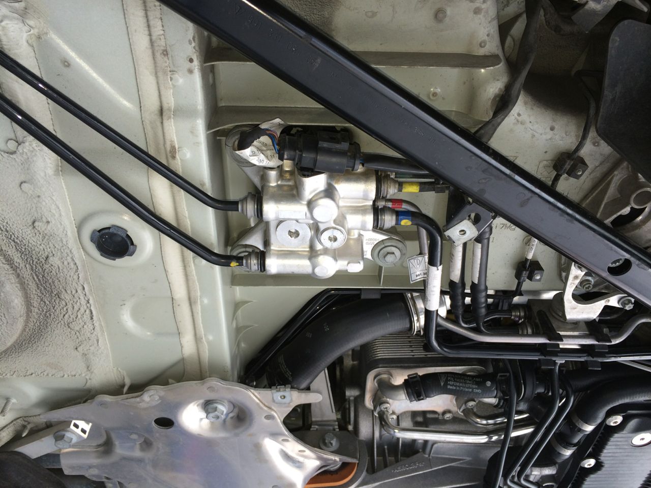

This post is a little bit off the topic but I took photos of the PDDC system for those who want to see it.
ID:	342102   Click image for larger version
ID:	342103   Click image for larger version
