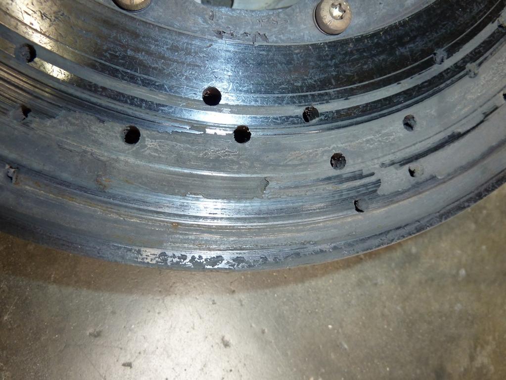

Is this what your rotors looked like?
Name:	rotor damage sm.jpg
Not at all. It's hard to describe because I have never seen anything like them before. They were like a smoothly polished metal sponge with shallow irregular depressions. I hope that helps.
