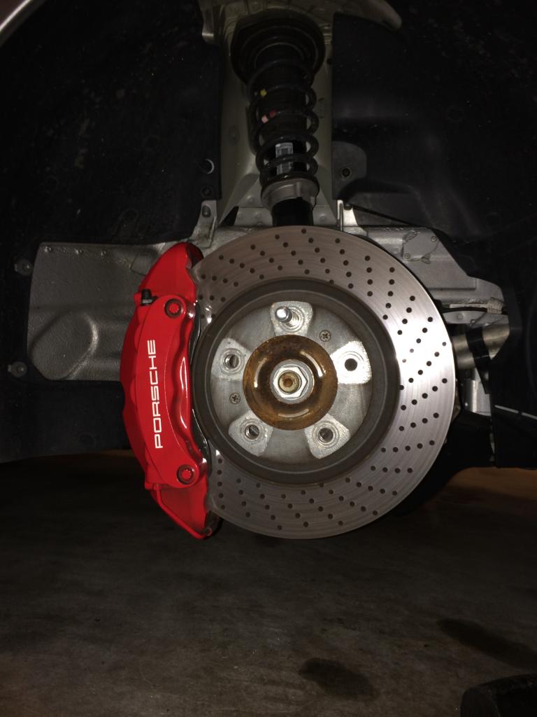

I removed the front passenger-side wheel. I had to hit the wheel a number of times with my rubber mallet to free the wheel. Made my case for using a tiny bit of anti-seize!
Here's the wheel removed:

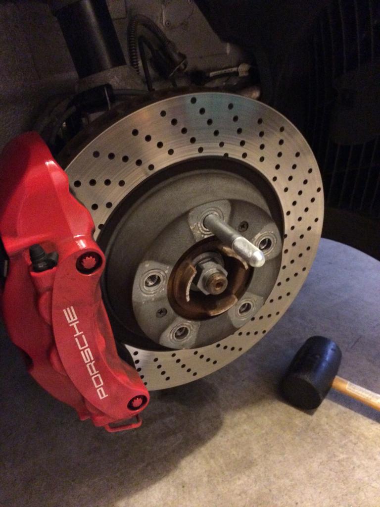

As in all cases, I got my wire brush out and removed as much of the rust and other build-up as possible, then cleaned with some brake-cleaner. I then applied a tiny amount of anti-seize to the hub, then pushed the spacer into place.

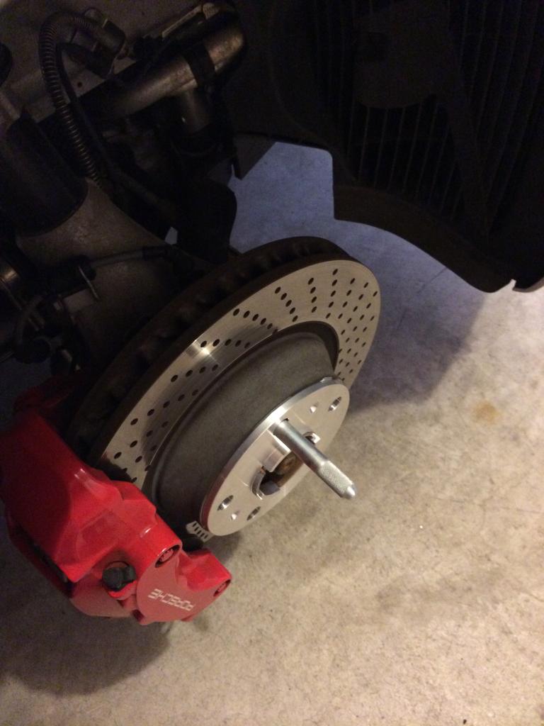

I used my rubber mallet to tap the spacer into place. All fit very snugly and well. I was happy!
Next I applied a tiny bit of anti-seize to the spacer plate facing, and mounted the clean wheel over the hanging pin.
I tightened everything up by hand, then lowered the car. Moving over to the drivers side front, I performed the same procedures, mounted the plate and wheel, and lowered.

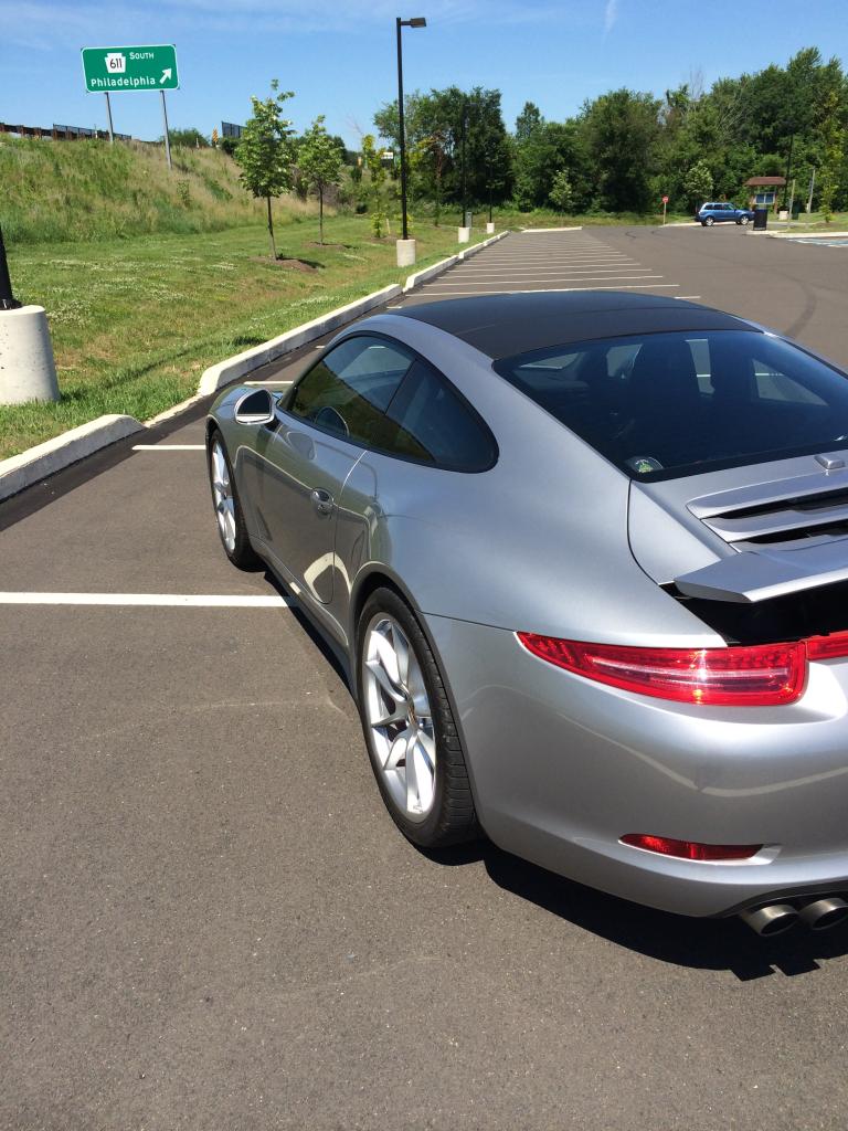

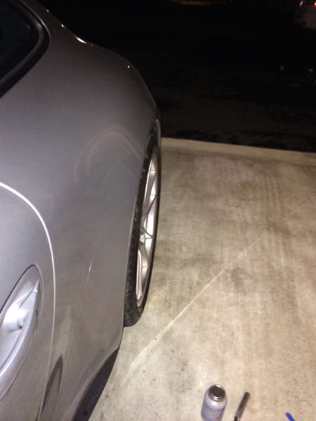

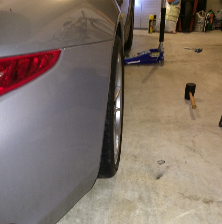

Unfortunately I did not do a great job taking before pictures to compare to, but here is what I have...
This is stock, "before" the drivers rear wheel spacer was installed:
And here is an "after" view of the same wheel well:

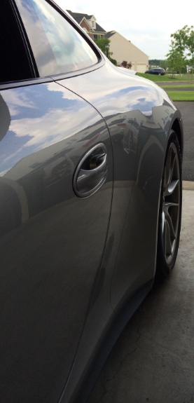

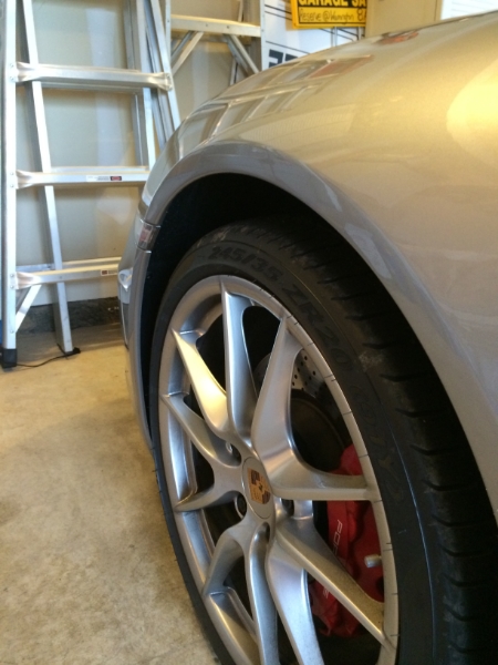

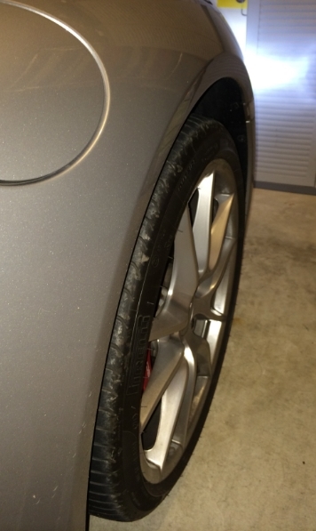

And here are some "After" shots of each wheel well around the car:
Passenger side rear:
Passenger side front:
Drivers side front:
And finally, following are some random shots of my car taken the day after completing the installation:
Thanks for reading! Hope others will find this useful. I will cross-post to the DIY section shortly.
