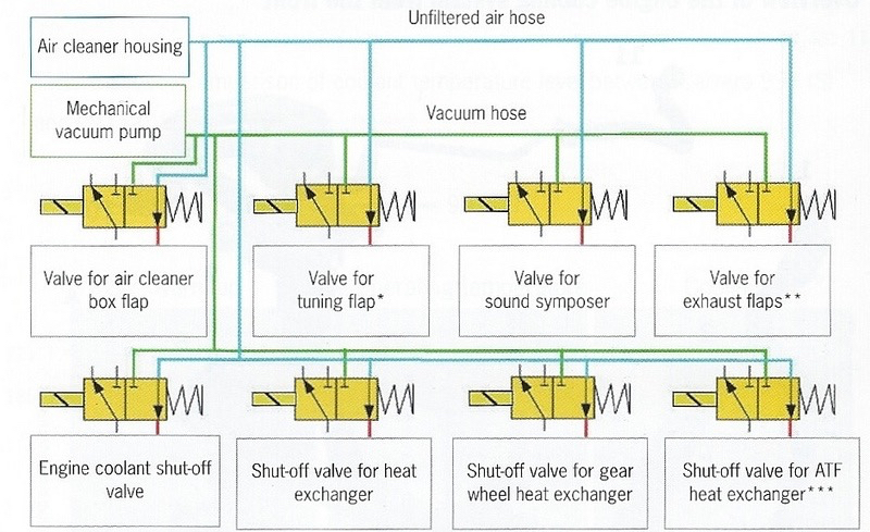

I do wonder what symptoms a failure of the other valves would cause.
Old Dec 30, 2014 | 06:08 PM
991carreradriver's Avatar
Joined: Aug 2014
Posts: 334
From: Northern NJ
991carreradriver has a spectacular aura about991carreradriver has a spectacular aura about991carreradriver has a spectacular aura about
Originally Posted by lunarx
Porsche just pockets the high profit on the 911 and leaves you with Chevy service.... I do wonder what symptoms a failure of the other valves would cause.
Here you go:
Frank C.
