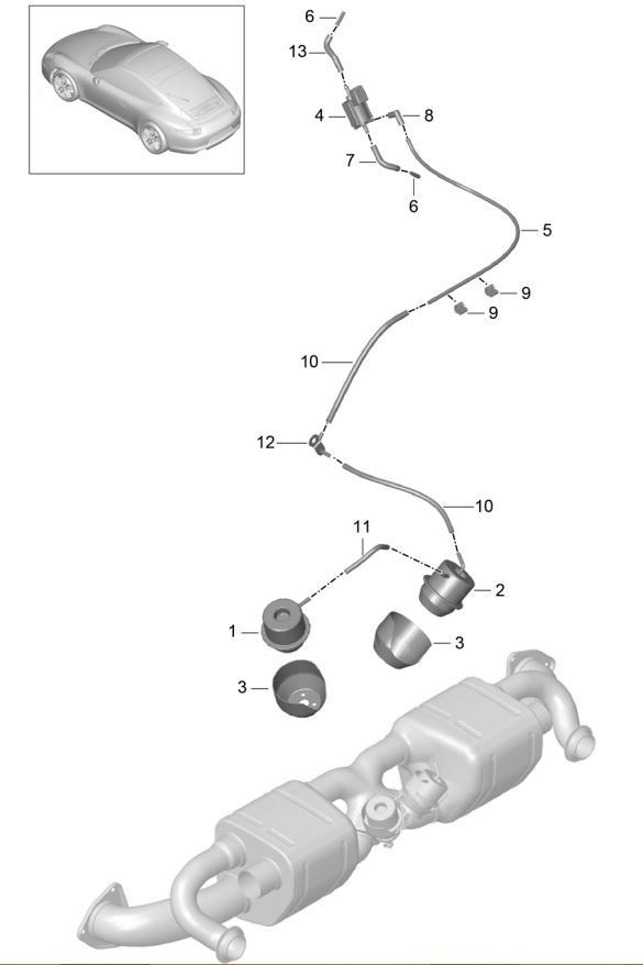

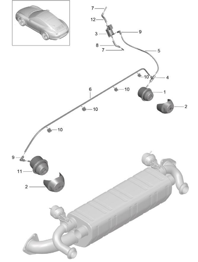

Originally Posted by cbrett
i recently traded that car for a 2013 C2S cab, non-PSE car. after reading reviews i want to add the AWE SwitchPath exhaust along with the PSE switch and vacuum lines. will these work together since my car is originally a non-PSE car? i don't quite understand the differences in valve locations between non-PSE and PSE cars. any advice would be greatly appreciated.
Since you have an "S" car, the COV and vacuum lines are already in place, and "automatic" opening and closing of the valves is governed by your engine RPM range. The only 2 differences between the PSE and non-PSE "S" exhaust configuration is the console switch (to override the "automatic" feature) and the center muffler. The vacuum hoses need to be a bit longer for the PSE due to the location of the valves on the center muffler -- may also be the case for the AWE.
Here's a side-by-side pic of the two exhaust configurations from the PET catalog....
First diagram is the "Standard" "S" car exhaust, second is the PSE.
When upgrading an S car with standard S exhaust to PSE, the center muffler is replaced, along with adding the console switch. So effectively when adding the AWE SwitchPath exhaust to that same car you are doing the same thing -- but you will need the console switch box and programming from the dealer.
Mechanically, adding the SwitchPath to a PSE car is well-documented on this forum and very much a simple DIY. Adding to a non-PSE S car should be nearly the same. AWE has a version for non-PSE cars I think, but if you are going to add the switch console get the PSE-equipped version.
Good luck and let us know how it goes!
thanks plenum for the diagrams. they are super helpful.
i assumed the same thing, ie i should buy the AWE for PSE equipped cars since i plan to add the PSE switch. however, i called and talked to two different suppliers of AWE and got different answers. one swore i should get the AWE for Non-PSE cars even if i plan to add PSE as the difference in AWE packages is related to the inherent hardware on a PSE car vs non-PSE car. i am going to call AWE again on monday and try to get a straight answer. thanks again for the help!
Yes when in question just contact AWE directly. Regarding S standard exhaust to PSE exhaust, from what others have already discovered the only direct change is replacing the center muffler. The SwitchPath is the same approach- keep side mufflers and swap-out the center muffler. Just like adding an X-pipe.... And this can be done by the average DIY'er in their garage (see Money365's Journal for excellent pictorial). What others have already mentioned to also be aware of is that you may need to lengthen the vacuum hoses or reconfigure. Other than that I don't recall there being any other difference in direct install of the AWE.
As for the console switch - you can purchase and install yourself just as easily (see my DIY- there is a single cable) but will need the dealer to program so that the switch actually works.
