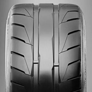

Just an FYI, those Nitto's are R-Compounds and while you are right, they stick like glue they are not the best for a street tire for these reasons:
1) They have minimal puncture resistance, prone to flats
2) They are not full tread depth when new, which means not so hot in the rain
3) They ARE sticky and will sandblast the wheel wells slinging sand and dirt off the tire because they pick up everything on the road.
4) Noisy (may not matter on a Cobra)
5) R-Comps wear by heat cycle, not by mileage. Every time you go for a drive its a heat cycle. Eventually they get a bluish-cast to them and the stick is gone.
6) They tend to cup more than a street tire when getting worn out.
But if ya gotta have 'em - ya gotta have 'em. Have fun.

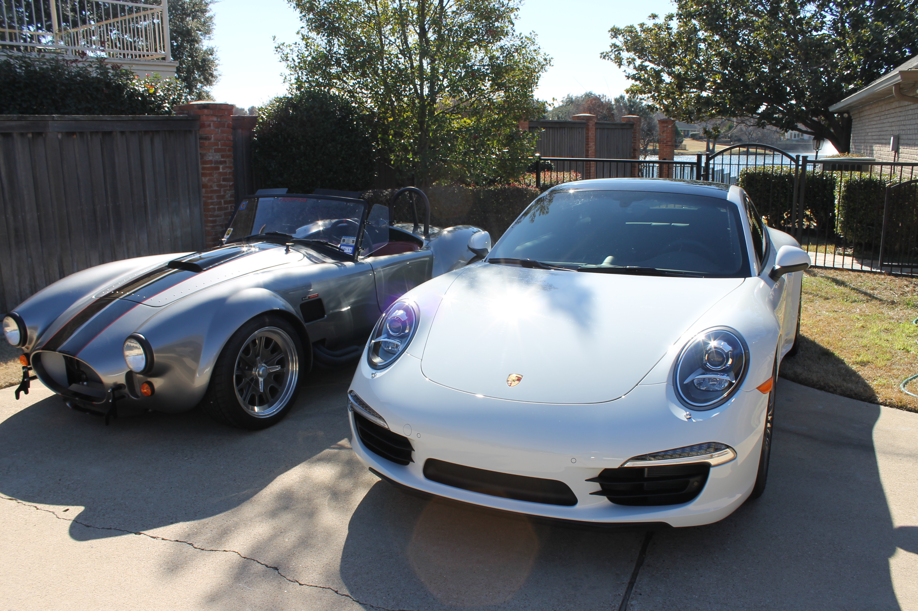

Welcome to the madness, be careful with the cobra, a 600 HP snake will bite ......
Thanks for the tip, I have time to reconsider. What are your thoughts on Nitto NT05's? Knowing this thing wants to kill you I am trying to hedge my bet with sticky tires.

Detroit:
I run Nitto 555R Drag Radials on my Backdraft with a 400hp Coyote. Sticky tires certainly help but in the end it's the driver that makes the difference. With 600HP, you will certainly be able to break any sticky tire loose in 1st, 2nd and probably 3rd. You might want to find a local ride with a cobra owner to see how light these cars are and decide if you really want 600HP. I have seen 350HP cobras drivers get in real trouble..... If your going with Superformance, this is an excellent choice, they hold their value and are very close to the original spec. Be prepared for a lot of attention ....

I don't personally run Nitto brand tires, I'm a Michelin/Bridgestone/Pirelli guy so I can't tell you anything about the NT05. If that were my Cobra, I'd install Michelin Pilot Super Sports. I have run many, many sets of R-Comps though (BF Goodrich, Hoosier, Yokohamas) and they don't stick until they get good and hot, so 600 HP romp off a stoplight isn't going to make them stick that much better than a street tire because they will be cold. They also don't stop very well when they're cold. You have to get about three laps around a track to build heat in them to get the advantage of an R-Comp, then they're like YEAH-BABY. So if you want to run sticky tires, get a autocross compound tire like the specialty Hoosier, because those are designed to stick without a lot of heat in them as there are no warm-up laps in Auto-X. They wear extremely quickly though, you'd be lucky to get 3K miles out of a set.
