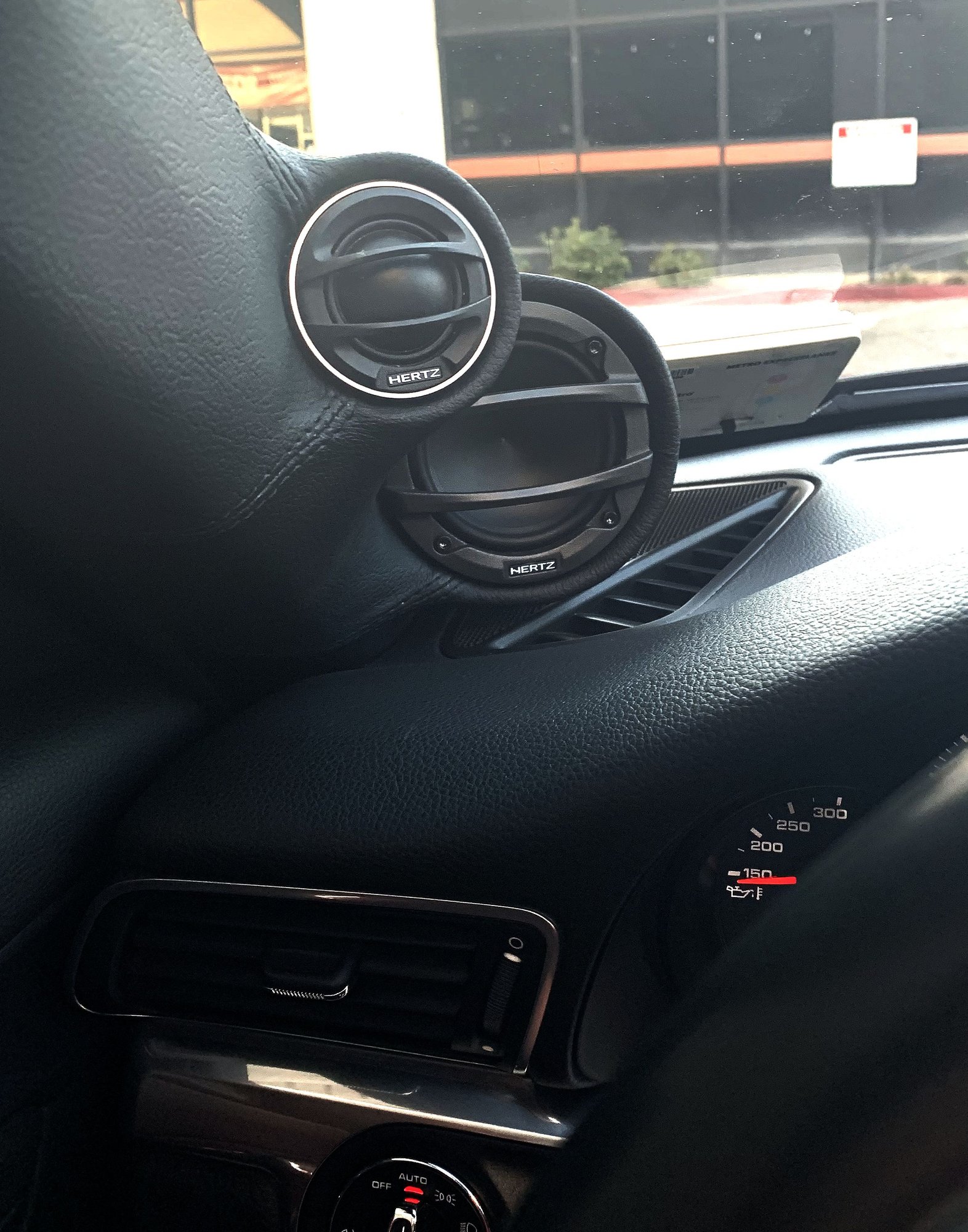

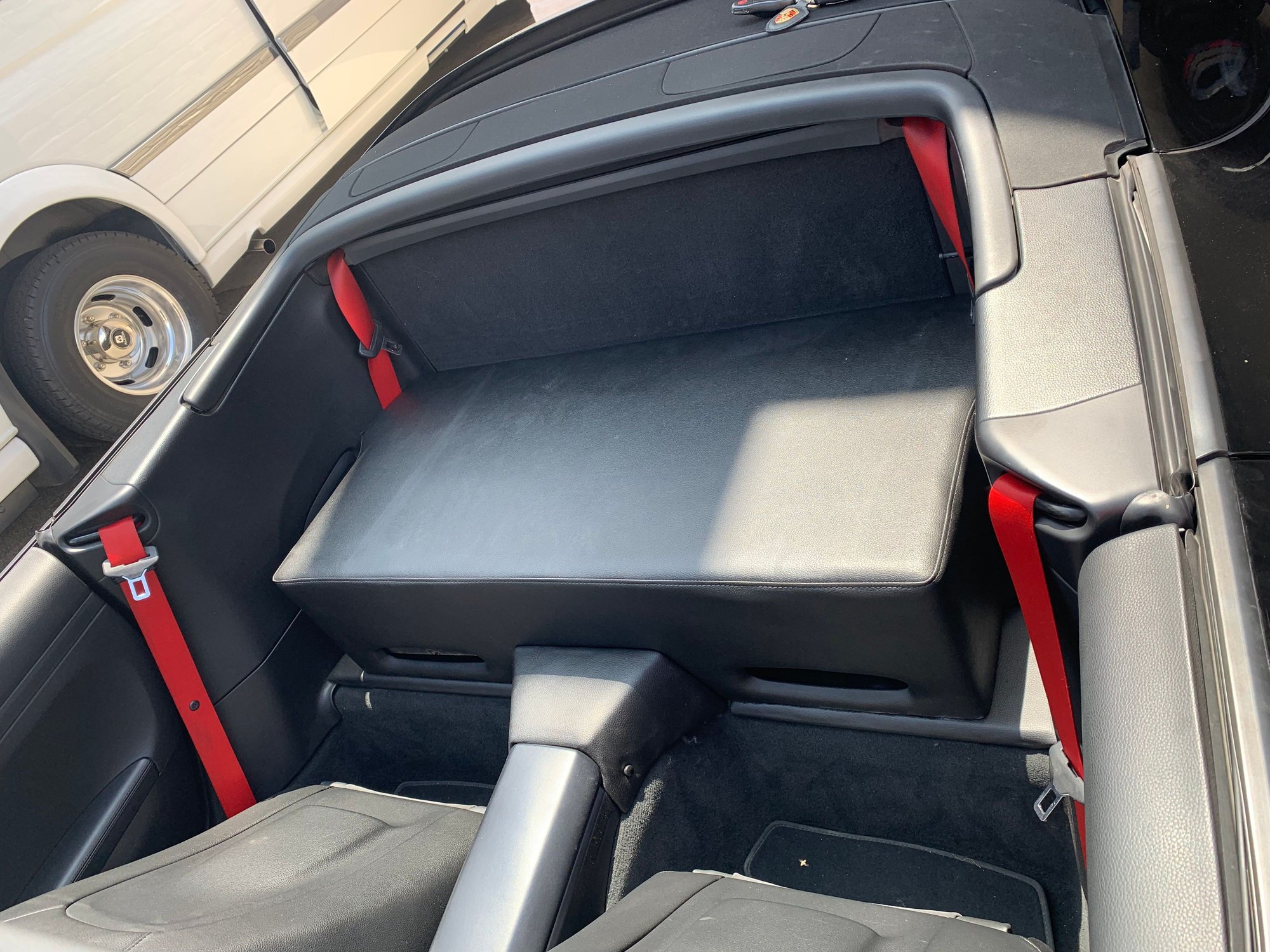

very cool box! how much did the cost cost?500,1000,1500?
I also completely replace the Bose crap my 991 had.
PCM swapped for Pioneer NEX 8400W (wireless CarPlay)
front stage:
Hertz Mille Legend 3 way component (run Active/no crossovers)
Alpine PDX V9 Amp + SoundDigital 400.4 Amp
Audison Bit NOVE DSP
Subs:
2x 10inch JL Audio 10TW3 Subwoofers in custom ported box.
I had my fantastic install Fantazy Motorsports in Thousand Oaks, CA dynamite everything, add a backup camera and fabricate custom A Pillars for the tweeter and 3inch speaker.
Its a fantastic system! To address a couple questions I read on here:
- The new speakers can play VERY loud without Distortion, so even with my convertible top down I can enjoy the music and not just win noise.
- The engine sounds great but I still like music
- Bose is crap, sold the speakers and amp on eBay for 500$
