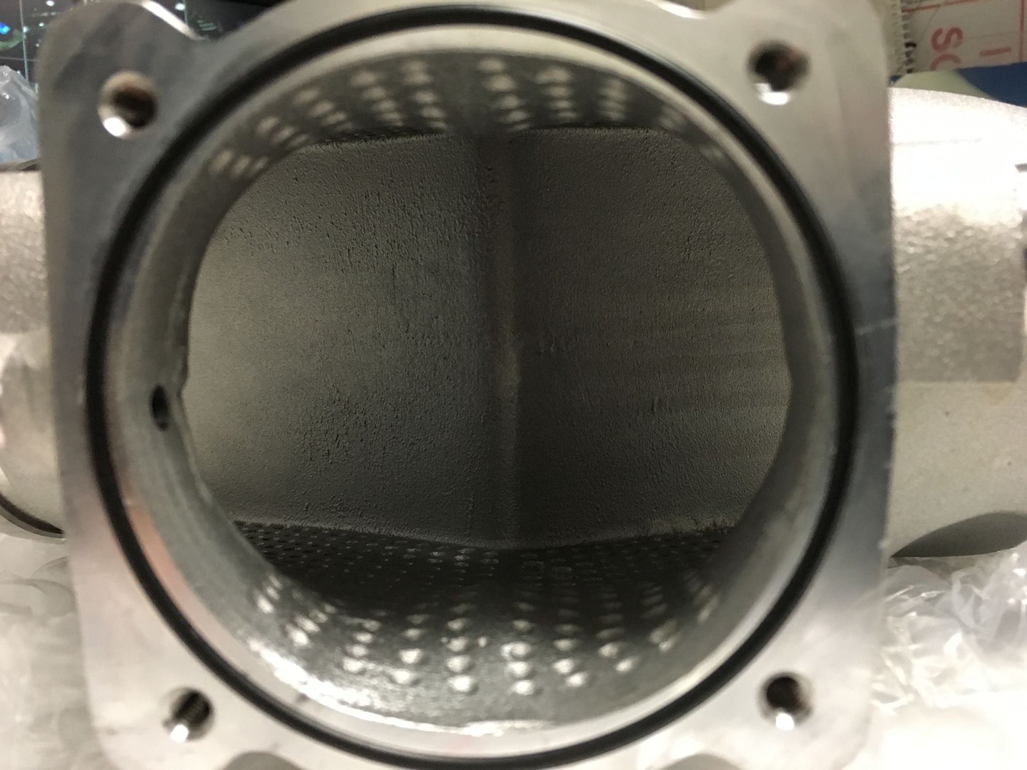

My 991 Upgrades

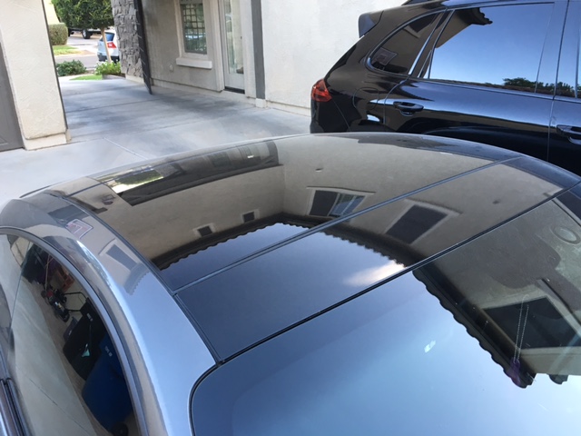

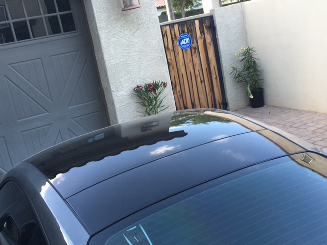

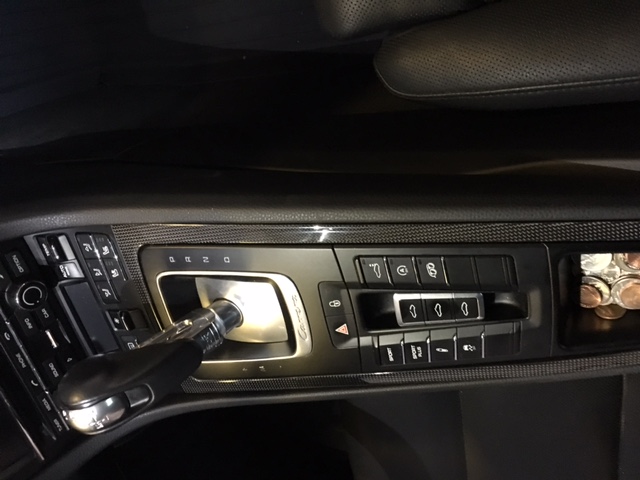

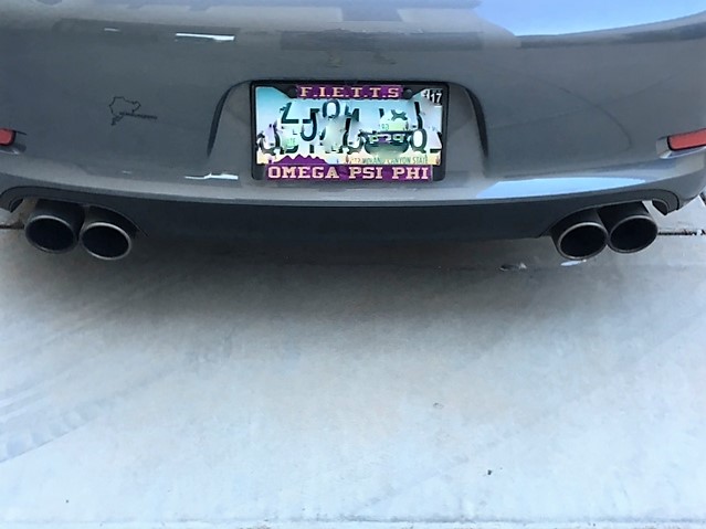

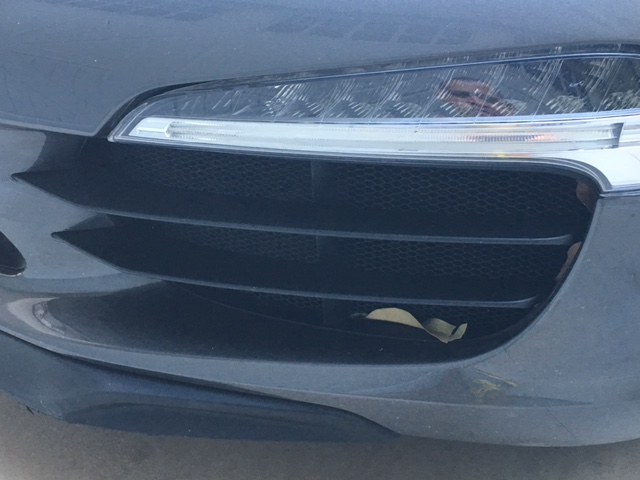

Planned this for a while every since I picked up my new to me CPO '13 Carrera S in trade for my '14 Cayman S both in Agate Gray. Car was nicely optioned with SPASM, PDK, and a few other goodies but lacked two things specifically I'd wanted. Those were PSE and the moonroof option. Thought the car was rather sedate with the OEM regular mufflers and kinda dark inside with the standard sunroof so after a bit of research and also quite a bit of Q&A between my dealer's Master Porsche Technician, Porsche, and a few aftermarket vendors...I added:
1) OEM Porsche Moonroof retrofit
2) PSE console and vaccum tube retrofit
3) PSE programming for #2

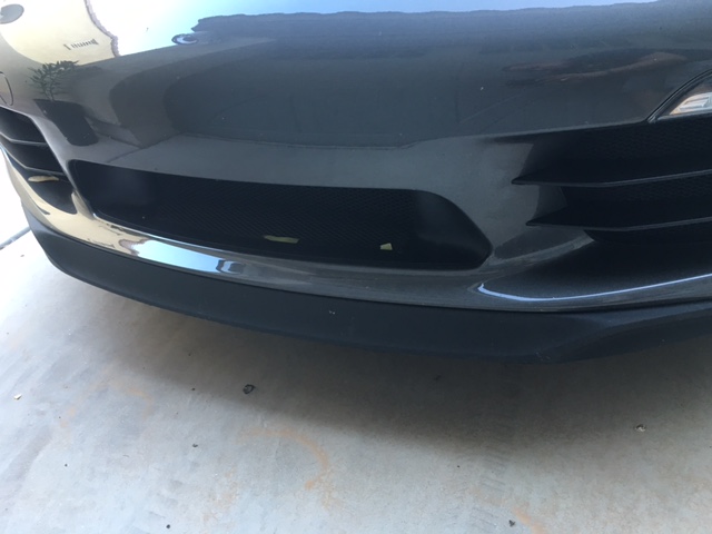

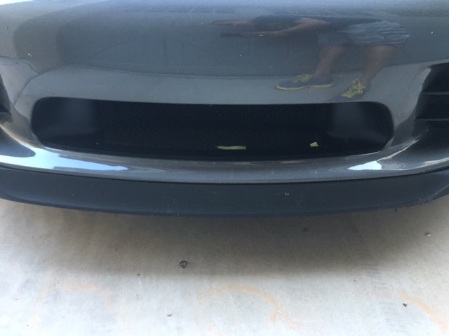

4) Rennline Front Bumper Grilles [black]
5) OEM Porsche Center Radiator kit

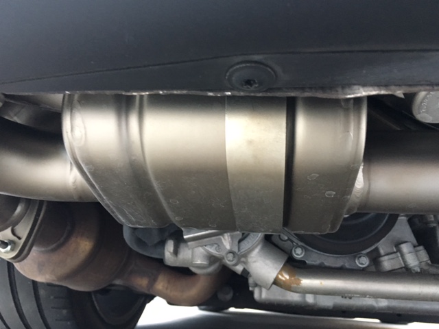

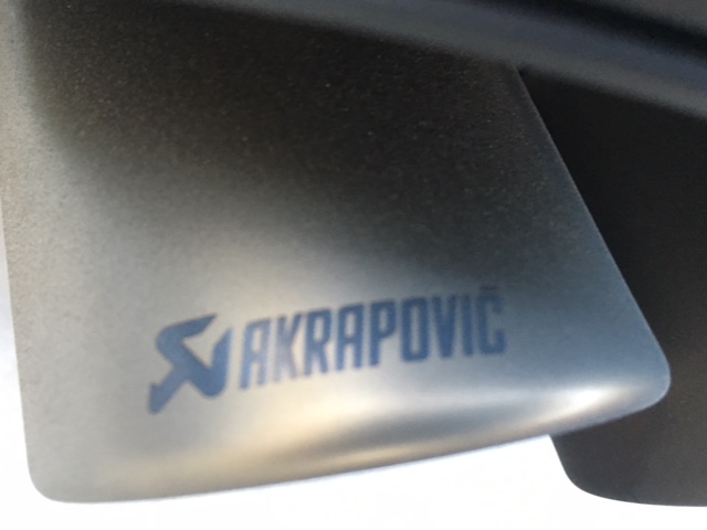

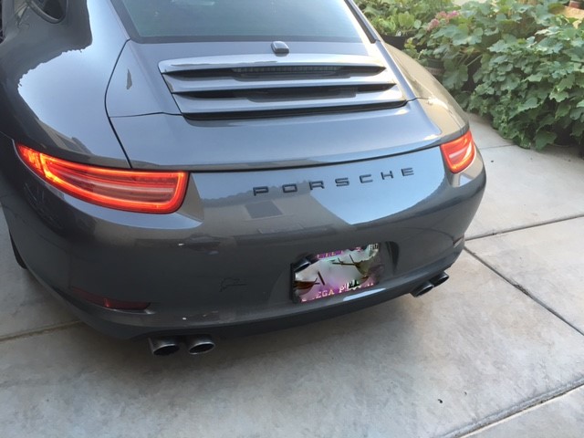

6) Akrapovic Ti Catback Sport Performance Exhaust

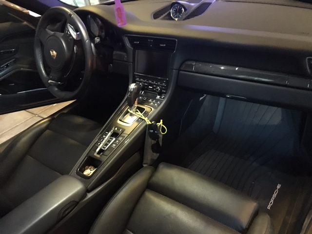

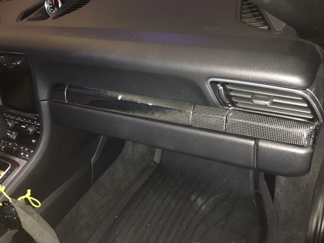

7) MACarbon CF interior trim retrofit (dash & center console)

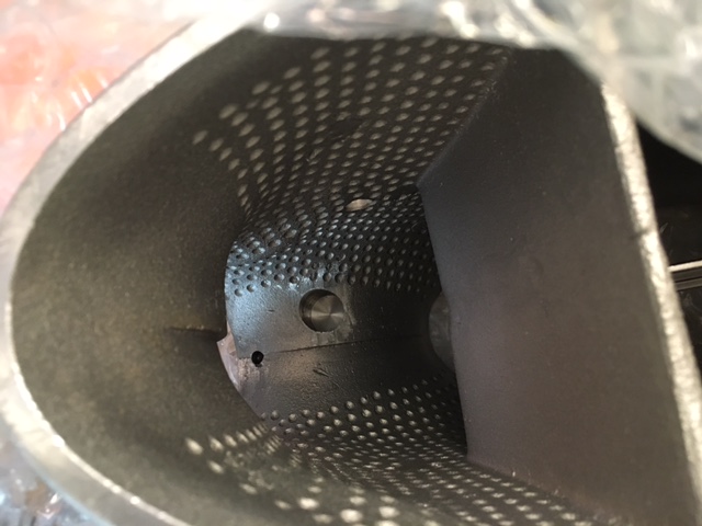

8) IPD 991 Pleneum

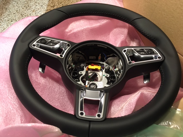

9) 991.2 GT Multifunction Steering wheel
10) 991.2 Steering wheel Airbag

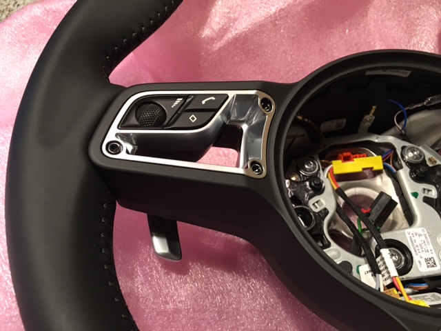

All of the above except item #7 were done by my dealer service dept while I handled the CF interior retrofit myself as a DIY (took me about 30 mins over an evening beef along with re-packing my OEM silver trim). The GT4 991.2 wheel does directly bolt on and work with the 991.1 generation cars...HOWEVER the multi-function controls do no code and the dealer couldn't get the new wheel controls to recognize and activate/work on the tester. So they replaced my old OEM wheel back on the car. Options include A) obtaining the 991.2 multi-function control module and seeing if that can be installed to control the wheel and also talk to the car's as well OR B) getting either a 991.1 Sports Design wheel + MF stalk or a 991.2 GT wheel minus controls and adding the MF stalk from the 991.1. Technician is not sure if option A) will work and I am willing to try IF the 991.2 module is returnable/refundable. Otherwise its likely option B as the OEM 991.1 MF wheel is just an eyesore to me. Not attractive at all. My old 981 Cayman S was ordered with the Sports Design wheel for a reason! If so will just sell the 991.2 MF wheel and airbag since they were special order items.

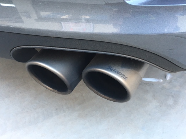

I'm in the same position as you re steering wheels. Think I may abandon multifunctionality and just get the 991.1 Sportdesign. It is a lovely wheel. Other option is a Techart conversion of the existing MF wheel, but I fear it may be, to coin a phrase, like putting lipstick on a pig.
How does the Akra exhaust sound, and have you noticed any power gains?
Exhaust sounds great. Just as I knew it would be and comparable to almost every clip out there I had viewed. Improves the car with a deeper and exotic tone that isn't too harsh or obnoxiously loud. Best of the bunch. Thumbs up!!!

Originally Posted by joec500
How much did that glass sunroof retrofit cost if you don't mind sharing?
$2k from Porsche. Its OEM part same as what comes with the moon-roof option when chosen from the factory.
