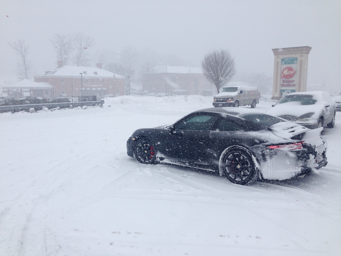

Whatever you do, it's a 100% different driving experience!!
