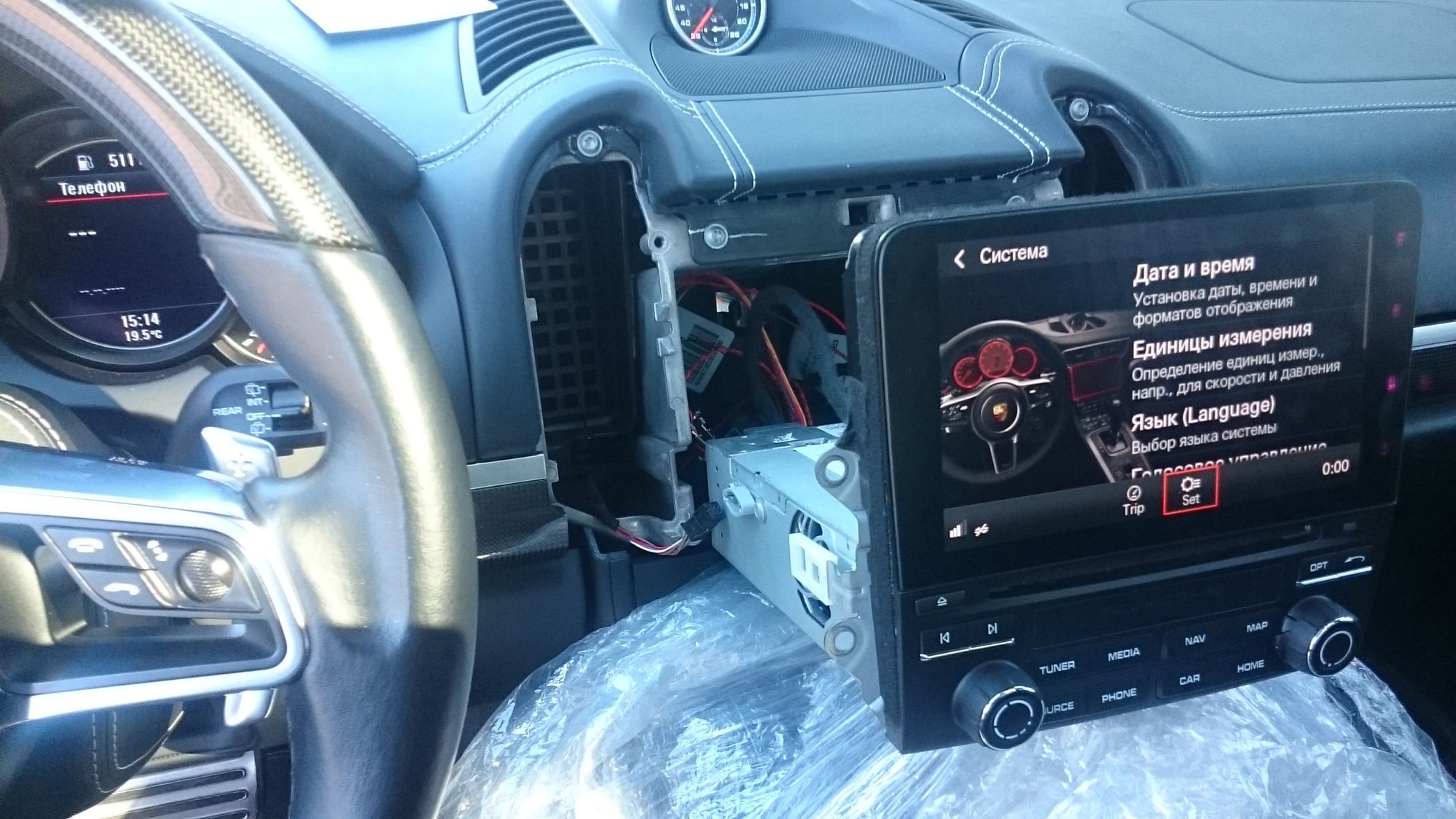

Old Apr 30, 2022 | 04:52 AM
Serg124's Avatar
Joined: Mar 2013
Posts: 567
From: Russia
Rep Power: 74
Serg124 has a reputation beyond reputeSerg124 has a reputation beyond reputeSerg124 has a reputation beyond reputeSerg124 has a reputation beyond reputeSerg124 has a reputation beyond reputeSerg124 has a reputation beyond reputeSerg124 has a reputation beyond reputeSerg124 has a reputation beyond reputeSerg124 has a reputation beyond reputeSerg124 has a reputation beyond reputeSerg124 has a reputation beyond repute
What you want to know? Huge parts list, pcm4 is not enough at all, lots of coding, and hacker job. So it's not a selfmade installation, unless you are skilled technician... New instrument cluster, new gateway, new amplifier, new parking aid control unit, new camera(s) and its control unit, new radio amp, two phone antennas, even usb plug is need to be changed. Steering column control unit and new steering wheel. Lots of new wiring. And theeeeen....))))
Old Apr 30, 2022 | 05:18 AM
Lee Turner's Avatar
Joined: Mar 2020
Posts: 13
From: St Kilda West
Lee Turner is infamous around these parts
Wow!!! That’s insane. I’ve already got the wheel but I didn’t realise the depth of what’s required and the skill. I’ve got no chance. I’d need to find someone (I’m in Melbournne) I’ve got no chance. Disappointing because I’d love to do that upgrade.

Well, to start you definitely need all parts laying down together. This will take time for sure. Then we'll see what can be done remote, what not.
Old May 1, 2022 | 11:13 AM
Serg124's Avatar
Joined: Mar 2013
Posts: 567
From: Russia
Rep Power: 74
Originally Posted by Elboy0712
Serg, any chance you would ever be willing to write up a guide for that retrofit?
Well, one day I will, for sure. I've done some cayennes and one macan so far, but 991 pretty close.
