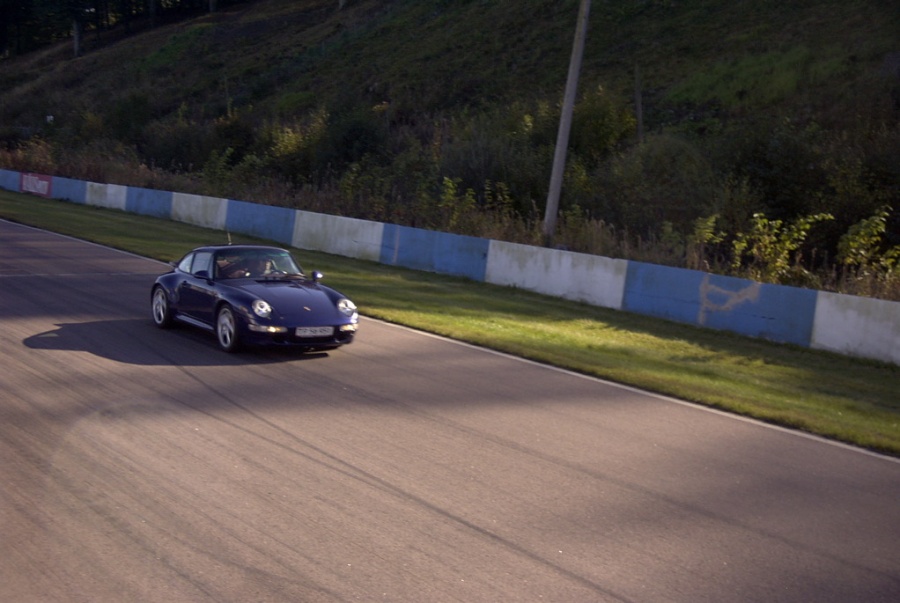

This car (sorry for the poor pic) has been standing out under a roof for 5-6 years. Nothing has been done to preserve it but a wash now and then. Its a 96 and has roughly 140k miles on it. Some of these on track and when it was shut down it had some oil leaks.
What would be needed to get it moving again? Which parts will be damaged from just standing there?
As mentioned nothing has really been done to preserve it. The exhaust havent been sealed off. Windows has been tightly shut and so on.
