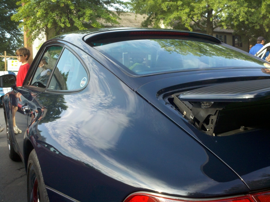

Pic of my 1997 C2 Coupe
At the Cars & Coffee- Great Falls, VA in August.....lots of fun...!
