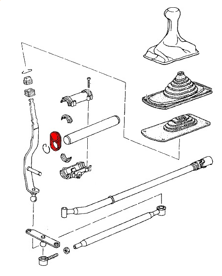

As I've researched this more closely, it looks like I need a shifter guide tube bushing. Any confirmation on the part number would be appreciated. It seems like it's loose on the end of the shift guide tube closer to the transmission, not the end that's closest to the dash. I checked Pelican parts for a diagram, but they seem to only show what looks like a bushing for the end of the shifter tube closest to the dash.

I would think along with the bushing you would also need the circlip. I suspect you need more then just those items from the sound of it, but without more pictures or looking at your shifter, it's impossible to say. For more information on the bushing and circlip Click Here.
I followed that link and see the reference to the circlip. Is the "SHIFT TUBE GUIDE" the rubber bushing for the end, or is it the tube itself?
thanks!
mtf
The Shift Tube Guide in the link is just the rubber bushing.
