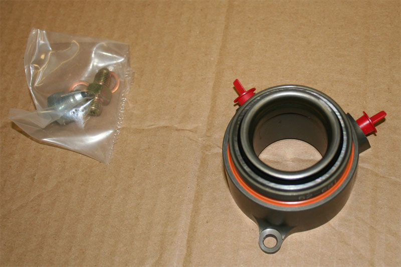

Using the Tilton supplied throw out bearing (same one used in the Supra kit) need to get the part numbers of it. I'll know more once we get the clutch in the car this week. What sort of issues did you have with the T-O and which part number where you using? (Below is a pic, I don't have the part number handy for this particular bearing as Tilton makes quite a few).
Almost all the cars we install Tiltons in are street cars (Supras), the carbon works quite well for street use at anything under 1,000-1,100 HP. I know some of the EVO/WRX guys where using cerametalic to save money, but many switch to carbon units for wear reasons.

Tilton part#61802 for the bearing,#6573USGG512 or the clutch, #51-4008 for the flywheel, all these are for the Porsche set up.
Originally Posted by onelove
Using the Tilton supplied throw out bearing (same one used in the Supra kit) need to get the part numbers of it. I'll know more once we get the clutch in the car this week. What sort of issues did you have with the T-O and which part number where# you using? (Below is a pic, I don't have the part number handy for this particular bearing as Tilton makes quite a few).
