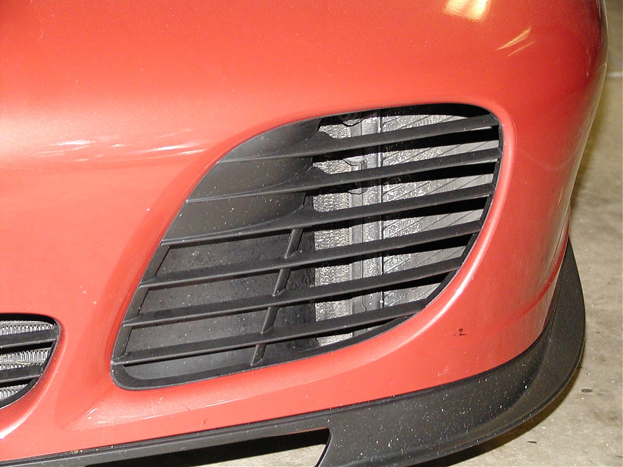

If you remove the bumperettes, you can fill the hole by ordering replacement front grilles that cover them. There are some version of the replacement parts CD's with the wrong part number. They are actually the same part, but the one for the bumperettes has a corner cut out of it.
I tried to find the part number, but it's escaping me at the moment. let me know if you need me to look harder for it.

Very cool. This is what I was wondering when I was looking at it this afternoon. It looks like something you could remove and replace just the side grilles.
If you wouldn't mind finding those part#s, I'd really appreciate it!

I've attached a photo of the grill. When the bumperettes are installed, the solid upper corner is removed. I found the part numbers, and there is good news and bad news. The bad news is I can't recall which is which! I think the 564 is the one with the full grille.
P/N in PET: 996 505 563 0001C
P/N with corner in grille: 996 505 564 0001C
There is a similar number for the other side. Please check carefully with the parts guys before you order to make sure you get the right ones. As I recall, they were overpriced, somewhere in the $130 each range. You might be able to convince someone who has changed the front bumper cover to let some go.

So what are the steps to remove these warts? Based on your pic FastFwd, it appears that the only hole would be the grill portion(no damage to the body itself)...which would be later fixed with the new part numbers you mentioned...Am I correct?

I'm also curious about this. Sorry for bringing this thread back from the dead but just want to make sure that there is know paint work needed for the bumper when replacing the grills. Thanks.

Nope - no paint work. You have to remove the bumper, remove the bumperettes, then pop out the grilles and replace with the new ones.
