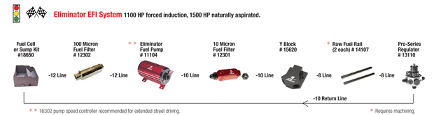

Is any body ready to share this info
Is any body ready to share this info bcs some people when i asked them,i got no replay, i guess they like it to be a secret and i respect that .
anyway id like to know the fuel line size in EVOms GT850 setup and injectors size .
this is a diagram from Aeromotive and I'm wondering if EVOms using the same lines size ?

You can easily do a 1000hp with an -8an feed line IIRC. A -10 or -12 or -14 line would be for some big power (1500-2400hp).
You could get away with an Aeromotive Eliminator pump (MAYBE a Pro Series pump if your in the 800rwhp area) easily. You don't have to go by what EVO does because all they did was copy a design every other car uses. If they in fact think they did invent the fuel system design they need to check out Mustangs and other fuel injected cars that have been using the same style setup since WAY before the 996TT came about.
Just my little rant about keeping things secret
i already got the Aeromotive Eliminator pump plus the other parts . just need to know the fuel line size
