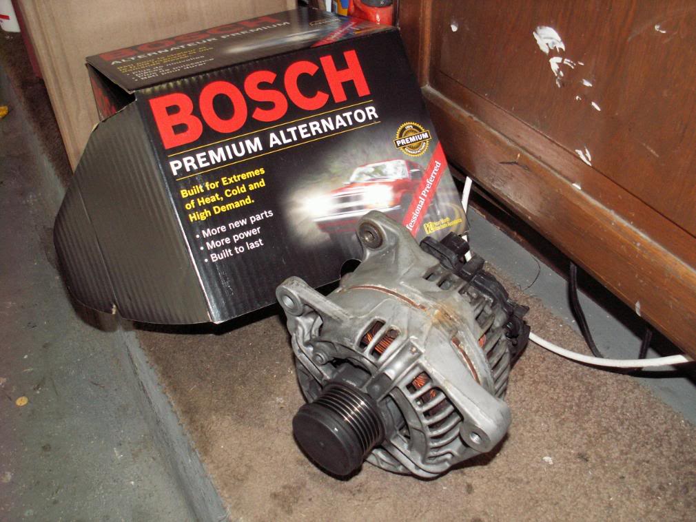

I just finished replacing mine today. I pulled my old one off (2003 MY04 996t) and it was this part number:
Porsche now recommend a 150 amp part number, 997 603 012 07, $1100 from Sonnen. I ended up going to my local Bosch dealer and reordering the same part number as what came off:
$400 brand new, you couldn't pay somebody to rebuild your old one for that. I started it up and from cold it was charging at 14 volts and when warms drops back to about 13.5V
