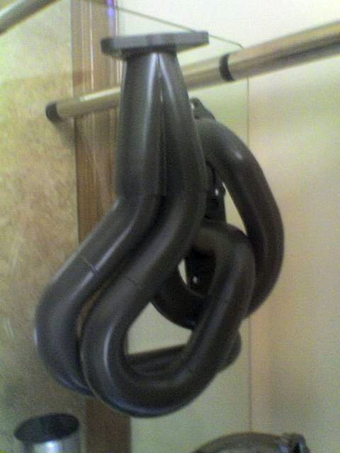

I don't consider myself a thermal engineer, lol , but I have been in the header/ceramic coating business for 20 years to date and coat Porsche headers, tips and turbocharger housings on a daily basis..here are some examples of blk and dk graphite oil based ceramic finishes. there are other finishes also available.
