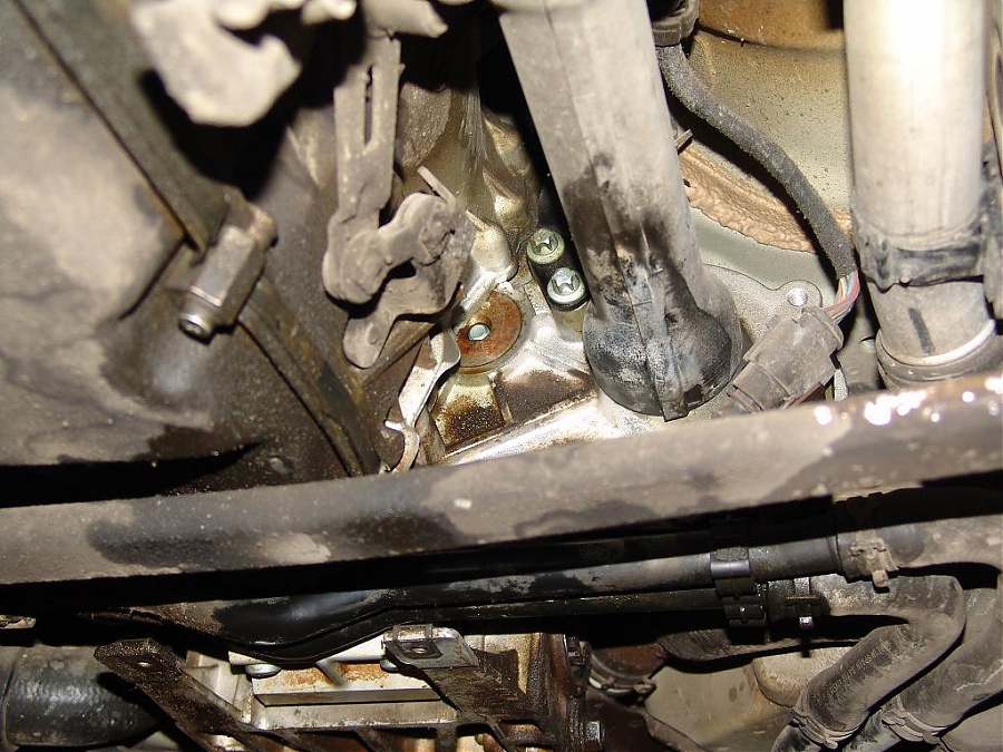

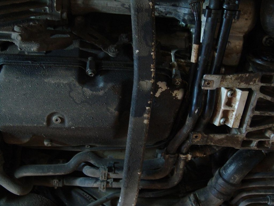

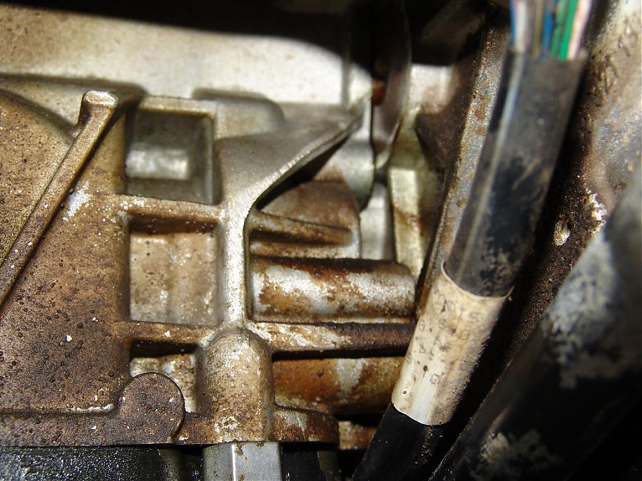

the leaking of my car is coming form here
if somebody knows something please HELP !

Old May 7, 2008 | 12:20 PM
boca996tt's Avatar
Joined: Apr 2008
Posts: 2,101
From: Huntington NY & boca raton florida
Rep Power: 106
boca996tt is just really niceboca996tt is just really niceboca996tt is just really niceboca996tt is just really nice
yes looks like same area as mine

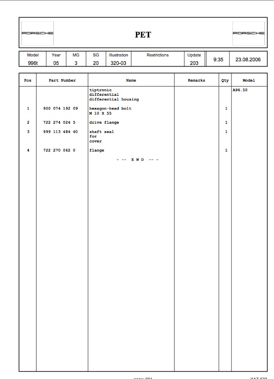

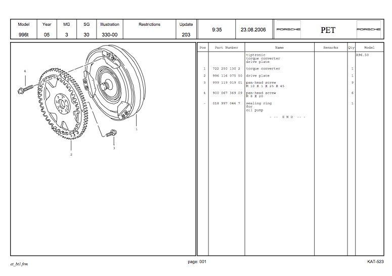

this may help
Old May 9, 2008 | 12:48 PM
colorinc's Avatar
Joined: Jun 2007
Posts: 935
From: USA
Rep Power: 91

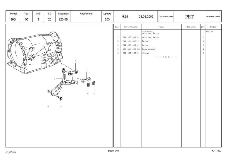

colorinc has a reputation beyond reputecolorinc has a reputation beyond reputecolorinc has a reputation beyond reputecolorinc has a reputation beyond reputecolorinc has a reputation beyond reputecolorinc has a reputation beyond reputecolorinc has a reputation beyond reputecolorinc has a reputation beyond reputecolorinc has a reputation beyond reputecolorinc has a reputation beyond reputecolorinc has a reputation beyond repute
part 2

alex55 Is a GOD !alex55 Is a GOD !alex55 Is a GOD !alex55 Is a GOD !alex55 Is a GOD !alex55 Is a GOD !alex55 Is a GOD !alex55 Is a GOD !alex55 Is a GOD !alex55 Is a GOD !alex55 Is a GOD !
thanks but i have this
