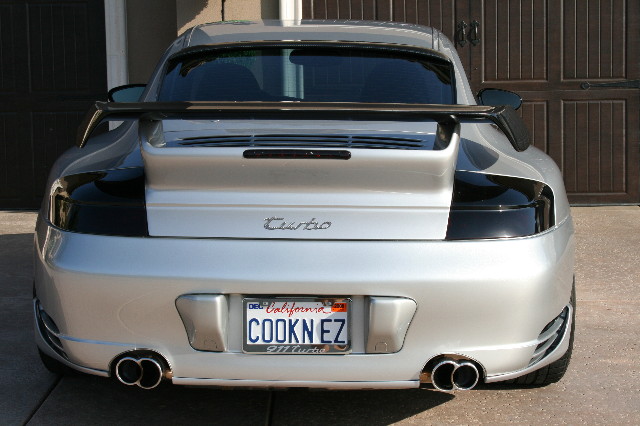

Here is a pic of mine which I installed myself.

^^^^^OMG, exact look I'm going for! (In the rear)^^^^^

yeah I'm going for the same look along with the new headlights with the inside painted black as well, looks great!
