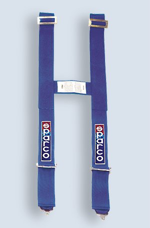

Anyways, I can use a 6-point anti-sub type system to wrap around my thighs because the factory seats don't have the pass through hole. The problem is the shoulder straps. I've seen people use a special strap to secure the shoulder straps together because the factory seats have the integrated headrests without holes for the straps. I think there's one that mounts behind the headrest and I've heard of one that mounts across the sternum.

Jack, do you mean a shoulder harness with a "H" pattrern.

Oooooo. Yep. I guess that's it. Does Schroth make one? I already had Schroth harnesses and would like to keep the same.
Anyways, are these safe? Anyone using them?

The 'H' straps may be questionable but companies are making them, so that's why I'm inquiring for people's opinions on them.
Are you implying that the H straps are not safe?

Jack, about the Schroth harness. Schroth only makes the harness' that are "V" shaped not "H" shaped like Sparco, so they connect the two vertical (shoulder) straps behind your head at the top of the seat. The seatbelt look like this.

But, and this is a big BUT, Schroth does not have the Porsche stock seat as an approved seat to use a harness on.
