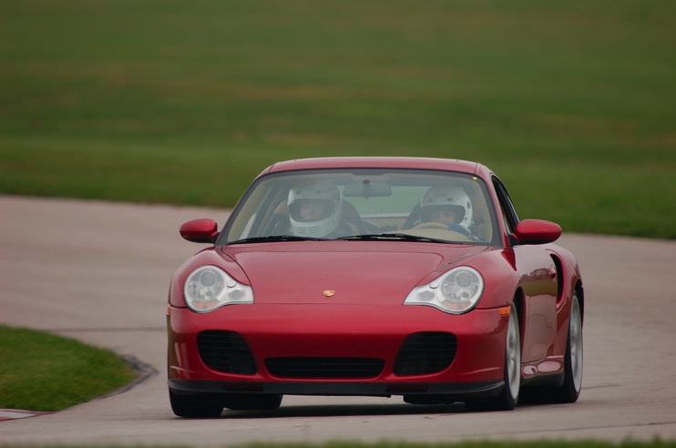

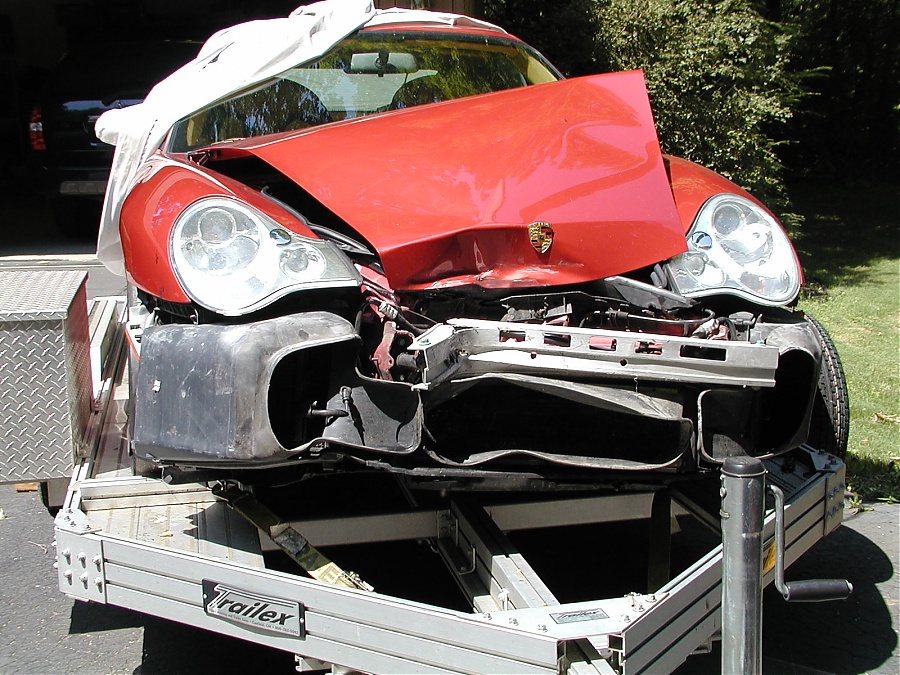

The difference is that my car isn't quite "square" up front. I have a difference of about 5-8mm left to right on the strut towers, so I max out one side before the other.
Goes back to last year, when I spun coming out of a turn, and collected the guy behind me. His right rear corner directly on my nose at a slight angle.
Everything looks right, but I'm left with this offset. For those on the board who are removing the front bumper support in an effort to lose weight --- I recommend against it. I'm not sure how fast we were going at impact, but there were no injuries and that bumper support absorbed a lot of energy.
Before and after shots below. The color difference you see is the lighting - only the bumper and hood were replaced and sprayed.
