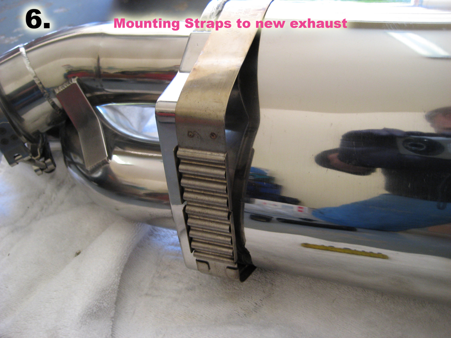

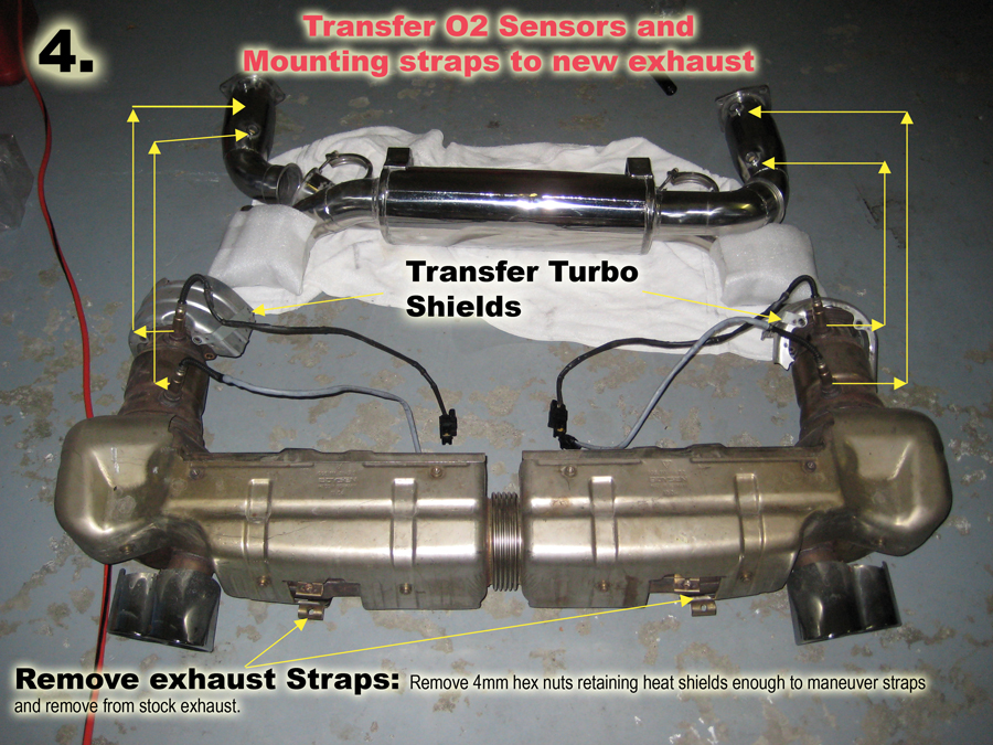

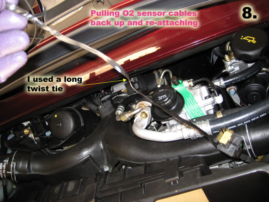

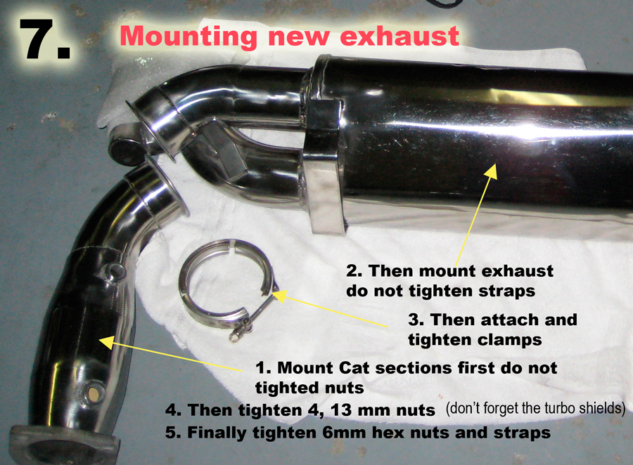

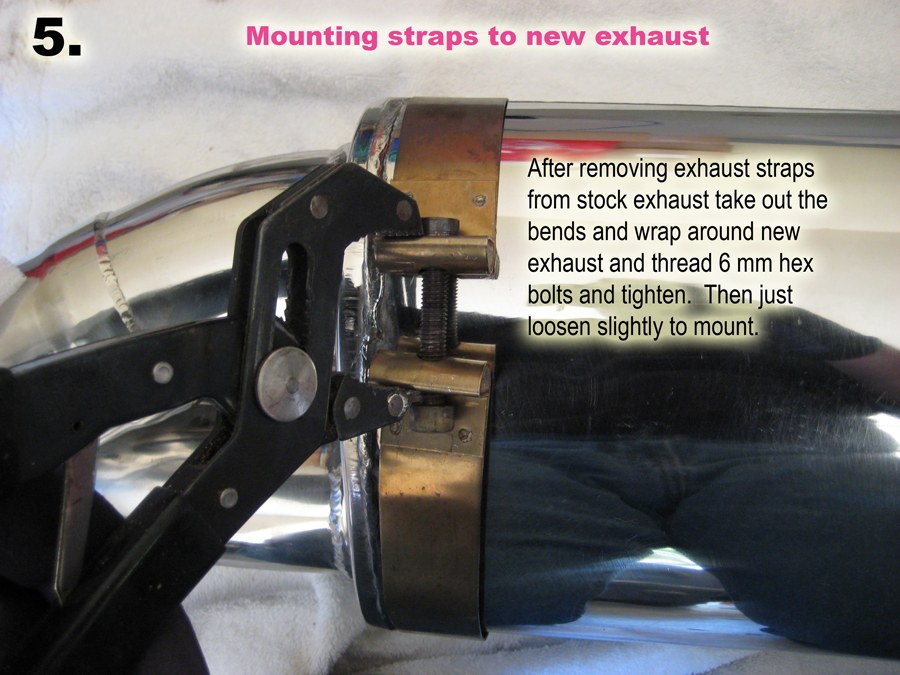

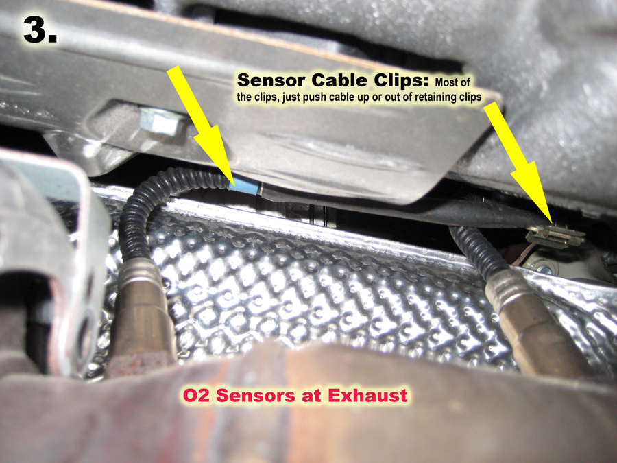

Here is my quick and dirty picture series on exhaust removal and install of my new RPI exhaust. A big thanks goes out to Ard, Porschedude996TT(he has an awesome and detailed write up) and others who helped me figure it out.
I love my new RPI exhaust.
Positives: Noticeable increase in power. I even broke the rear tires loose on hard acceleration. Never did that before prior to this install. Nice exotic sound beginning around 3200rpm increasing to redline. Sweet spot at 3000rpm for cruising not loud and very quiet at Idle.
Negatives: Droan starts around 1500rpm increases to max at around 2000 and decreases to 2700rpm where it pretty much disappears.
All in all a good investment in my opinion

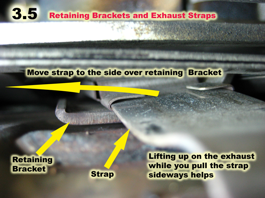

Originally Posted by KellyT
oops forgot one picture
The most important one!
Can't get exhaust off
Trouble removing exhaust
Trouble dropping exhaust
Exhaust stuck
So in all the DIYs I had read, I never saw a picture or read a discussion on these straps and how they 'thread' up through the fixed brackets- you need to loosen the strap and dramatically slide it sideways to get it clear of the bracket. Since the brackets on the muffler and the brackets on the car 'interdigitate' it is not enough to just loosen it.
If these are your 'quick and dirty' pictures, I'd love to see the good ones!
Nice work

Very happy with the exhaust. Noticeable increase in power. It reminds me of my Honda CR250 2 stroke and its big modified exhaust and the added power caused by the expansion of gases and correct hormonics of the FMF exhaust. The Sound and horse power seem to be tied together. The drone not so bad and is less when the system warms up.
Happy the pictures help. I pretty much cover the list of tools in the pictures.
