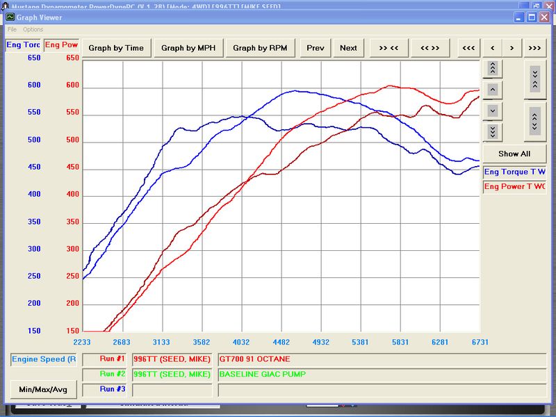

See my graph below on 91 octane. The GIAC flash adapts to higher octane as well. I know from direct communication with GIAC.
GIAC makes great products and have flashes for many setups.
