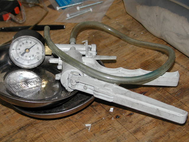

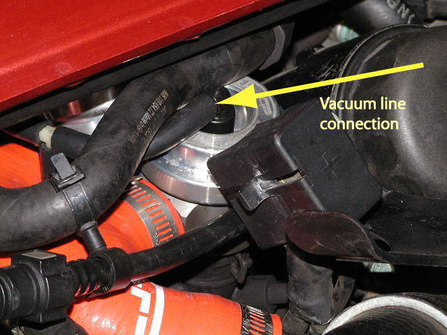

Yes, they are known to go bad. You are almost certainly going to replace them when you upgrade the turbos anyway, why wait? It isn't that hard to test them. Look at the photos below. Remove the hose at the top of the diverter valve, then pull a vacuum using a brake bleeder like the one shown in the second picture. You can get one at AutoZone. Test both of them. The one in back is harder to get to.
If they both hold vacuum, then this may not be your problem. But I'd be willing to bet it is. No disrespect to the guys who are blaming this on flaky ECU, but this is a much more likely explanation.
Jon
Thanks for the pics. Although I am very mechanically UNinclined, I will give it a shot!
