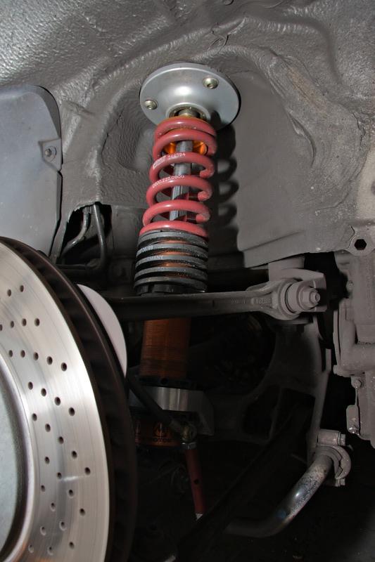

Thanks Dan. Unfortunately, I just confirmed today, that one of the fronts is coming off, again, due to a leak... 2nd time. This time my rebuilder is going to send the strut to Moton to be looked at.
Here's a peak at one of those Mode Monoballs you sent me. Looks almost stock!
