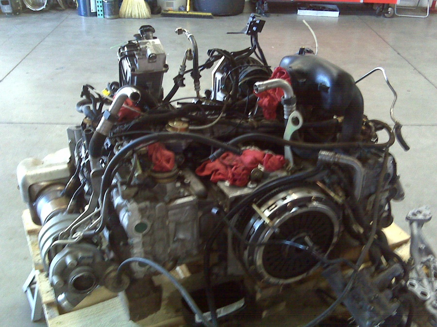

update...problem found
I believe I figured out the problem and thought I would revive this thread and update the board. I finally broke down and decided to take the car into my independent, and on the way there I threw a CEL! I was stoked to see the CEL, as it confirmed that my issues were most likely not simply my imagination.
Well, as it turned out I had a bad pre-cat 02 sensor. Not a big deal at all.
However, the day before I decided to take the car to the shop I noticed a drop of oil in the garage, and when I got under the car it looked to be leaking from the RMS area (which as you all know, really isn't a common area for the turbo cars to leak). So I had the shop check the leak as well, and the news wasn't good. The leak was coming from the oil tank breather area at the top front of the engine (which meant the engine had to come out to fix...ouch).
It turned out that there was an o-ring that was virtually cut in half in one spot, and seriously nicked in another. $6 dollar part. Below is a pic of the engine (sorry for the crappy phone pic quality). The red rag just above the flywheel is pluging the port to the engine where the o-ring leak occurred. The good thing is that while we were in there we freshened up a few of the seals and gaskets, and replaced a few cheap parts/hoses, etc... as a precautionary measure. We also replaced the fuel filter, tranny fluid, coolant, engine oil, polyrib belt, etc.... so I should be good to go for a while.
For what its worth, and I know this is a controversial topic, but we also changed the plugs back to the bosch plugs from the Densos I had installed a few months ago. My tech confirmed that the Denso's are great plugs, but probably weren't optimum for my giac flash (which assumes a certain type of plug). He confirmed with GIAC that although it may not actually cause drivability issues to run the iridium plugs, the safer bet would be to stay with the bosch plugs, so we changed them since access was so easy with the engine out.
The verdict: car feels stronger, and is much smoother (and easier to shift smoothly). My wallet is lighter, but I'm happy 'cause my car is sorted and feels just great.
When I factor in the cost of the repairs/upgrades I've performed since buying the car in mid-November, it no longer seems like the deal of the century (I paid 38.5), but I still think I did pretty well (even after buying new tires, fixing the leaking spoiler rams thanks to a great deal from a six-speeder, replacing the clutch, and then this repair). At least now I have a car that I have been assured is in tip-top shape, has NO issues, and is well-sorted mechanically and cosmetically.
Anyway, just thought I'd post this update and publicly thank those who helped me trouble shoot these issues (I know that I still need to ditch the heavy wheels, but they have really grown on me!).
