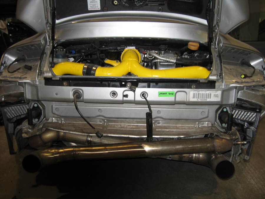

Ok finally got round to taking my rear bumper off, took circa 20 minutes once I figured how, needed a the jack to get to the philips screws at the top bumper corner in the wheel arch.
"Remove rear bumper cover: 4 phillips on top, 2 phillips on bottom, 4* 25 torx on bottom, 2* 20 torx in the wheel well + 2 phillips in the wheel well near top each top corner . Unplug the wires.(easy) " Bumper is very light in weight and can be easily handled by one person.
This is what Marksi car looks like with it removed, I haven,t got there yet but will tomorrow, I will leave the two impact rear units on just as he has though.
My front bumper support will remain on the car too.
