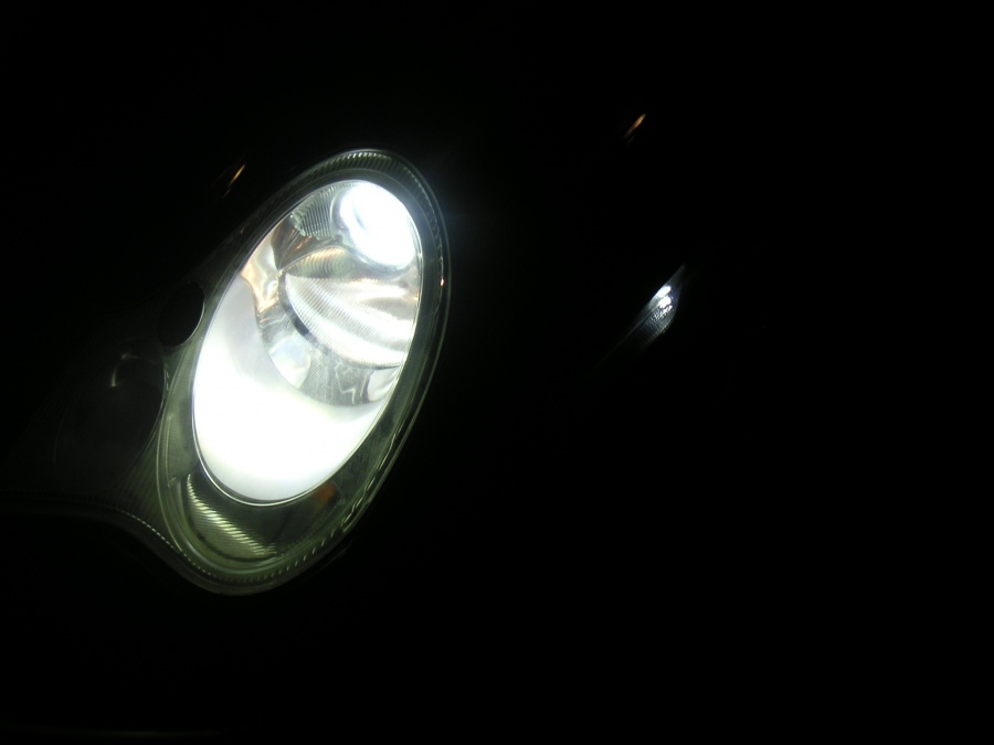

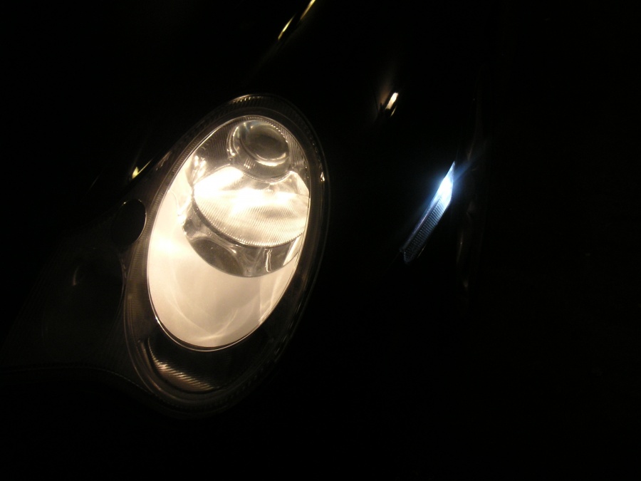

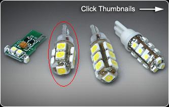

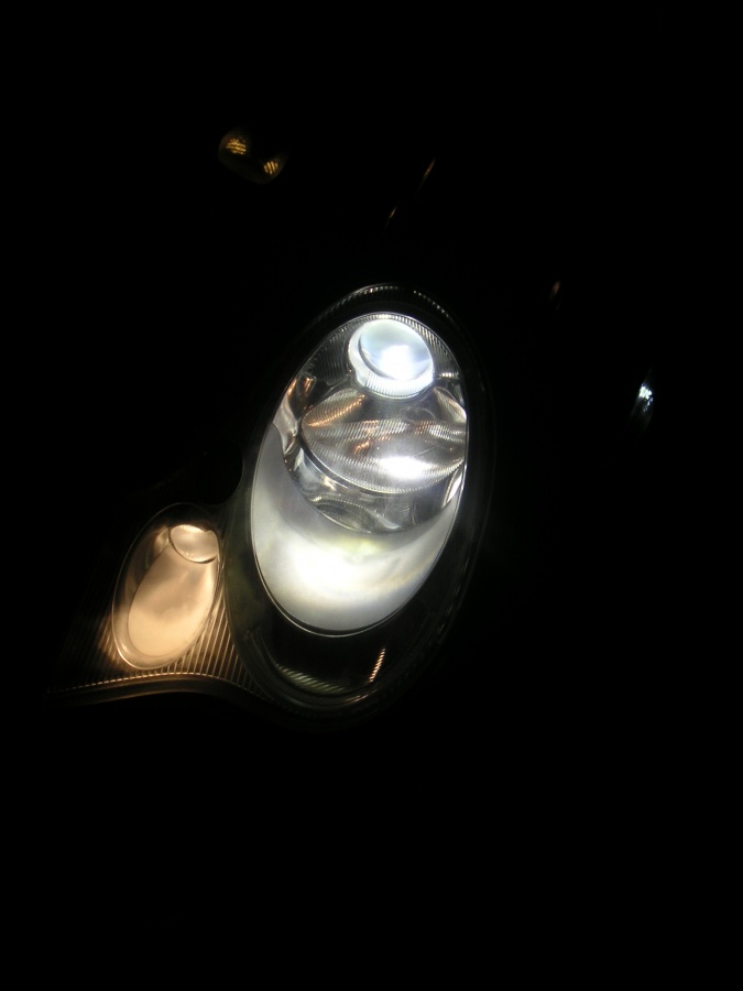

I am probably like most of the people following this thread that are annoyed by the varying mix of yellowish and bluish white lights on the TT. So with much thanks to M32 (Edwin), I installed LED sidemarkers today.
Here are the photos:
1) The LEDs from www.superbrightleds.com circled in red (they just fit)
2) The installed LEDs look great with the headlights
3) They look bad with the parking light (next install)
4) They look bad with the foglight
So I am thinking of getting these parking lights BAX9 from
http://superlumination.com/otherleds.htm
H6W BAX9s 64132 Bayonet Bulbs (Offset Bayonet Pins)
The Cool White 6 LEDs to better match the headlights and sidemarkers
For the foglights superlumination has these H3s
http://superlumination.com/headlights.htm
that would seem to match well.
Open to all suggestions here, but really what to rid the front of the car of the yellowish white.
--Blue Monster

I've noticed that if you want to match "cool white" or "white" Leds, your foglight will need to be either converted to a 6000k HID or get a h3 bulb that gives off that "look". I'm not sure who sells it b/c I'm going another route with my fogs
Edwin
