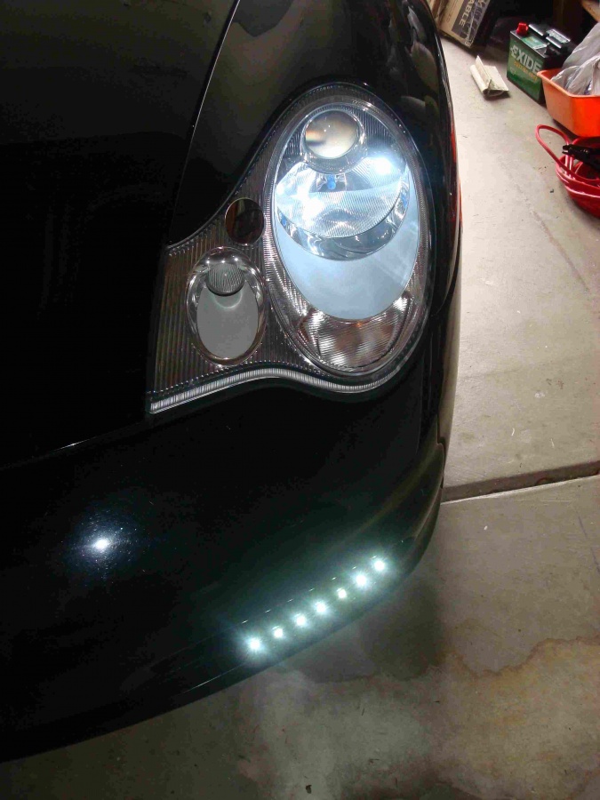

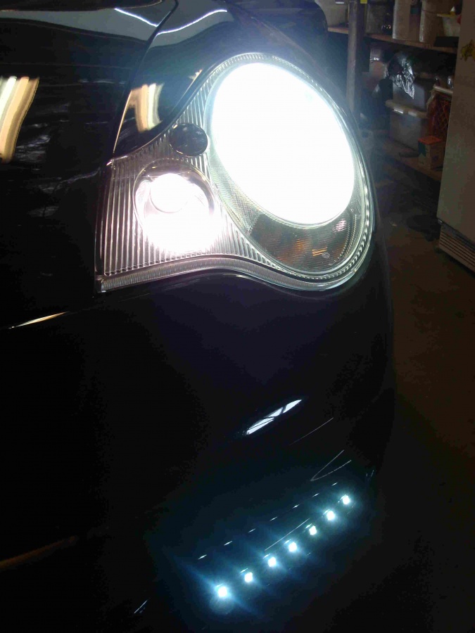

Please see the prior post for the bulbs/LEDs.

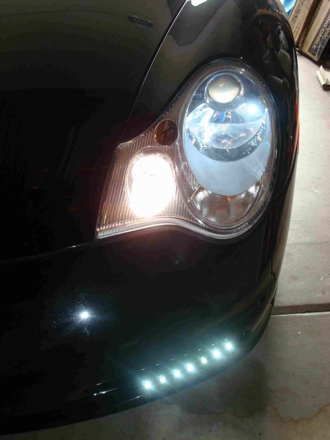

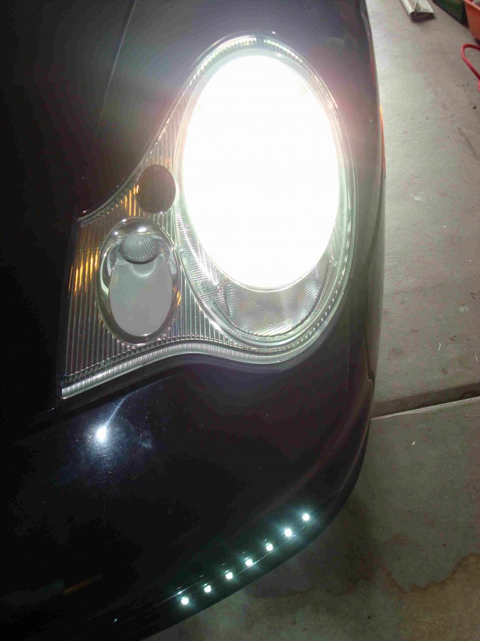

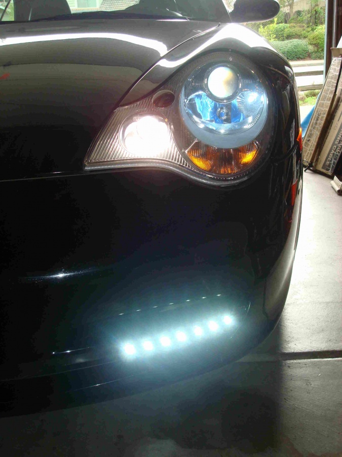

Name:  Parking Light & DRL LEDs.jpg
Name:  Parking Light & DRL LEDs 2.jpg
Name:  Fog 6K H3 - LED Parking & DRL.jpg
Name:  Fog 6K H3 - LED Parking & DRL 2.jpg
Name:  High & Low Beams.jpg

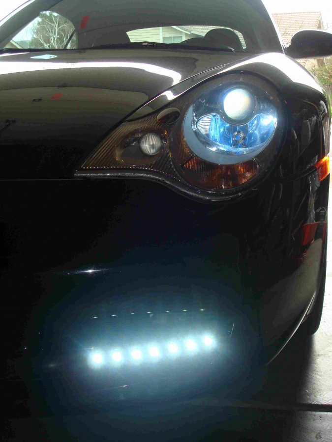

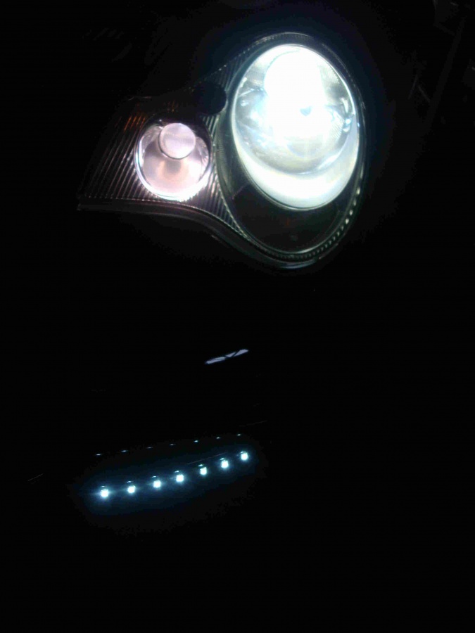

This series highlights the Low Beam 6K HID D2S and the 6K H3 Fog light bulbs. I'll post the 8K bulbs when they arrive.
Name:  Low Beam 6K HID D2S & 6K H3 Fog Light.jpg
Name:  Low Beam 6K HID D2S & 6K H3 Fog Light 2.jpg

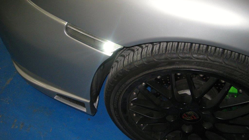

On the off-chance that this would help anyone, I did snap some night-time photos of the LED parking lights tonight. My timing was no good to compare the old lights with the new ones as my daytime pictures didn't turn out worth a damn, but at least you can see the color of the new bulbs fairly well here. These are the LED white lights, yet you can see they appear similar to the factory HID light color overall (with my house lights in the background more similar to the yellow of the factory bulbs).
Anyway, crummy pictures for sure...but the best I could do for now.

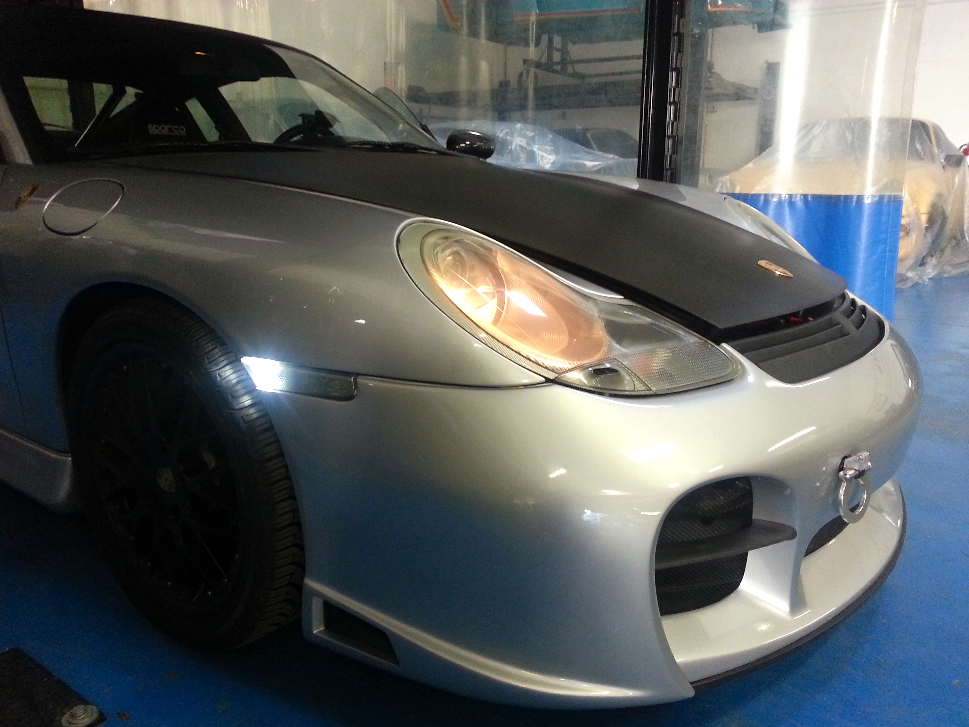

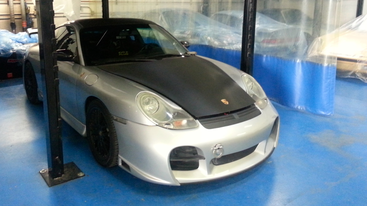

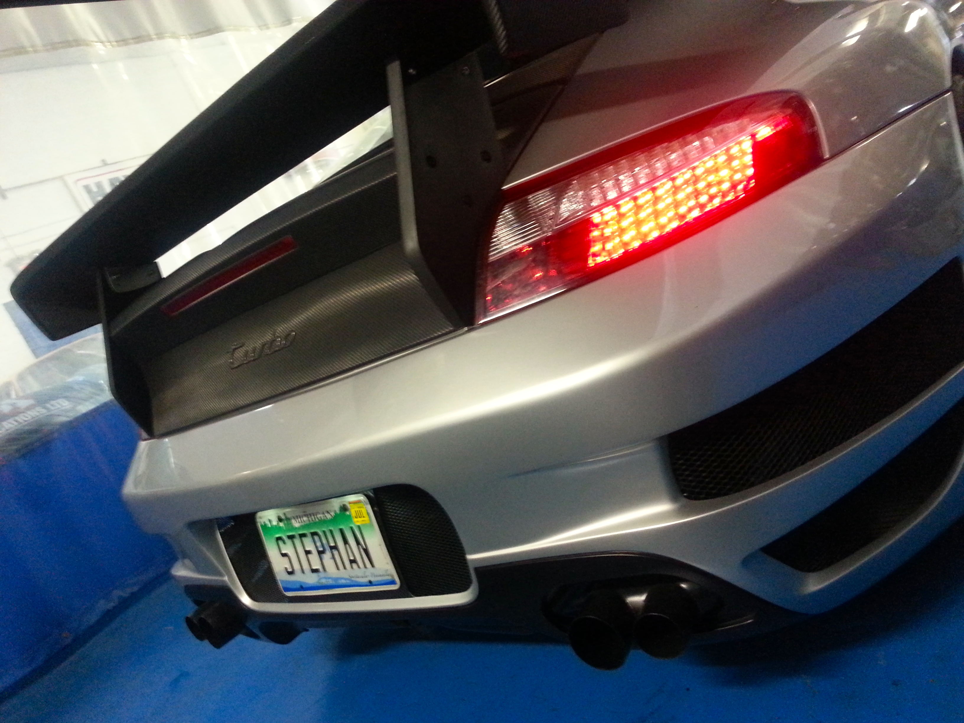

Greetings,
Great write up. I only discovered the SuperBrightLED website after already ordering LED Side Marker and Parking Light LED's. Side marker works great but the shop my car is at was having problems with the Parking Bulb LED, I emailed them your write up and told them to clip the bayonet like you did. The SuperBrightLED website is a little confusing. I also want to replace my Turn Signal Bulb and Fog Lamp Bulb but they have several choices and not sure what relay to use.
Did you replace any other bulbs with LED? I have a 99 911, would do you recommend for Turn Signal, Fog Lamp and Relay?
