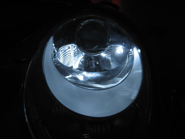

As some of you know, I added a set of LED's to my TA front and the little halogen parking light was really throwing the look off so I decided to change that (and the headlight) to LED.

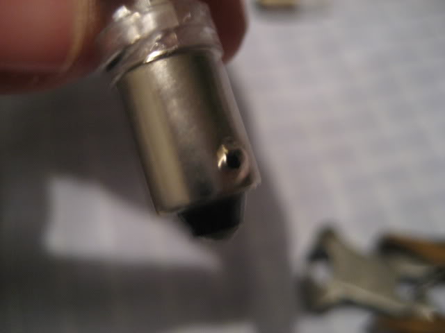

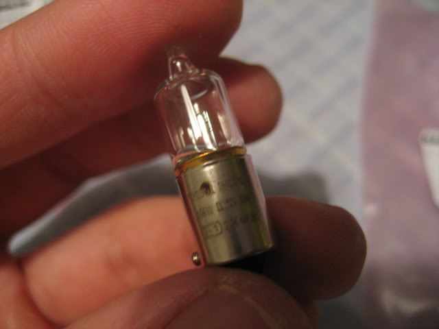

First, I had a pretty hard time trying to "decipher" what the bulb size/type is based on the porsche manual. The parking light bulb is small (size of a wedge) and base of 1156 bulbs
On the base of the stock bulb, note the prongs are at 9 o'clock and 2 o' clock. I search for a few hours to try to find a small LED bulb with the prongs like that but was unsuccessful.
I browsed through www.superbrightleds.com and was able to find a bulb that had the same size except for the prongs. (12 o clock and 6 o clock)

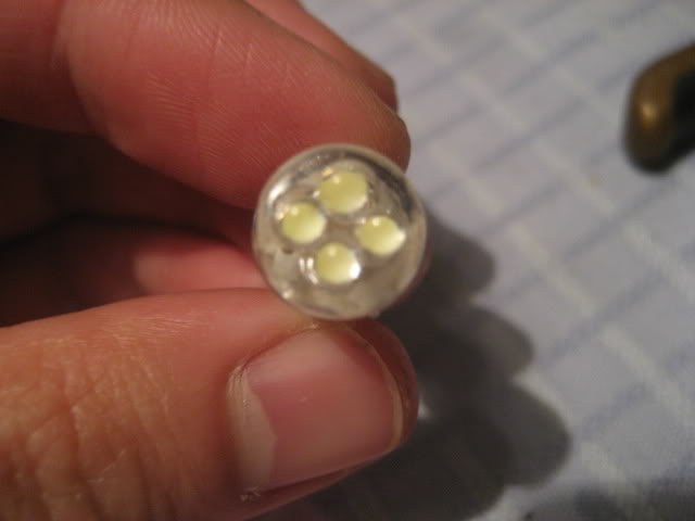

I bought two of each (4 led and 1 led). 4 LED

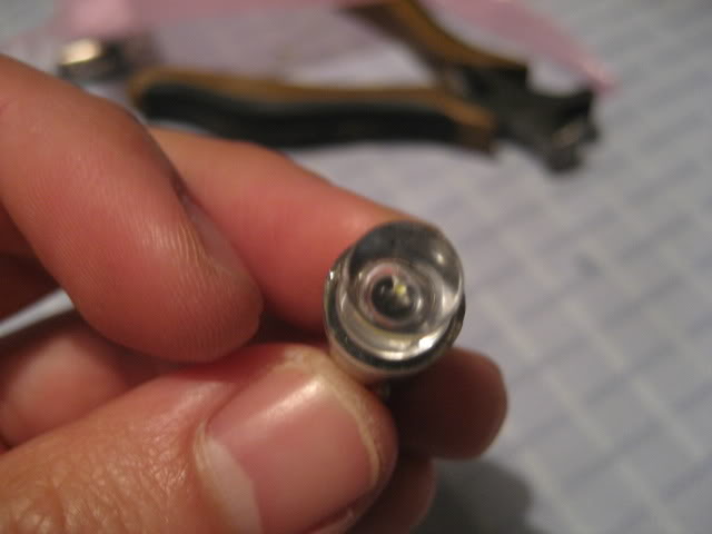

1 LED
I ended up clipping off one of the prongs and it works perfect.

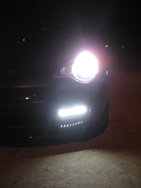

Here's a comparison on their brightness.
1 LED

4 LED

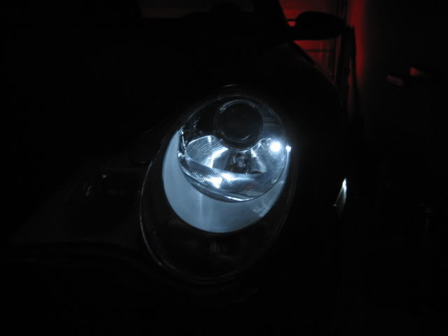

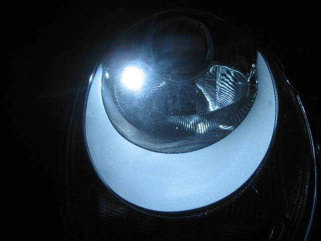

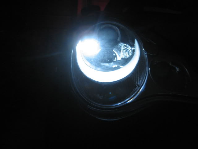

The color is not an exact match but it's definitely better than the halogen.
I also installed 8000k bulbs to see how they compare (obviously too blue/purple)

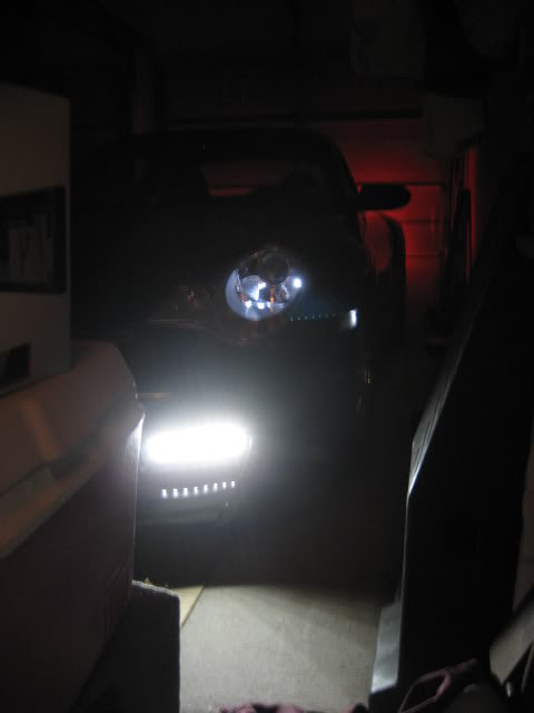

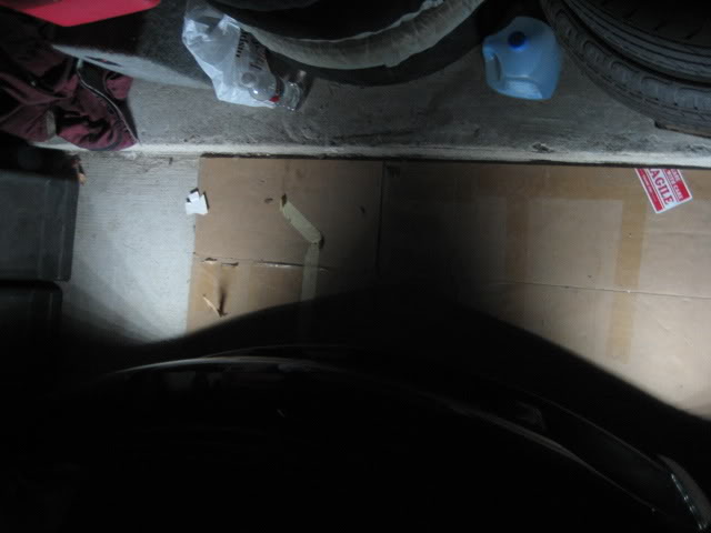

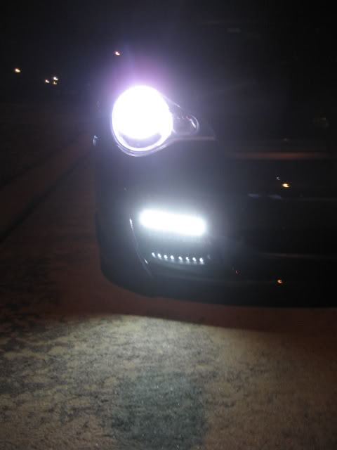

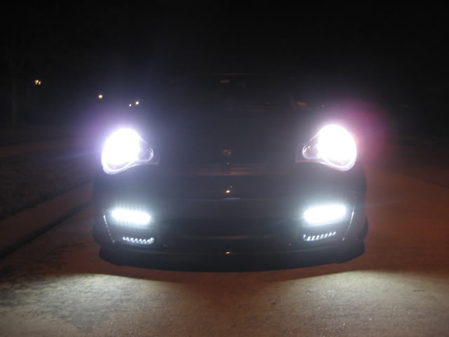

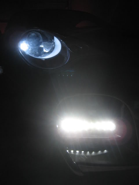

and a pic of how bright the LEDs are
