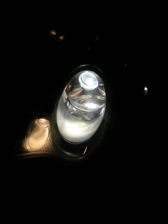

The mix and match of the white HID Headlights and the yellowish sidemarker, parking lights, and foglights always looked strange to me. For less than $40, you can make them all white. Here is what I used:

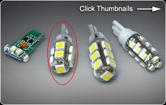

Sidemarker LEDs from www.superbrightleds.com circled in red (they just fit)
Parking light LEDs (BAX9) from
http://superlumination.com/otherleds.htm
H6W BAX9s 64132 Bayonet Bulbs (Offset Bayonet Pins)

here are the photos:

Feb 20, 2009 | 05:49 PM
An addtional photo
this photo shows the transition a little bit better
