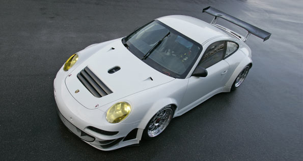

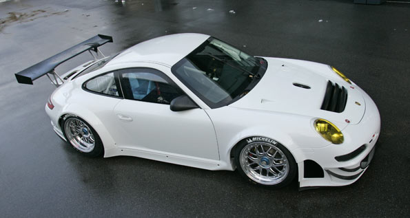

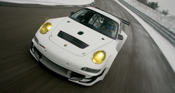

Take a look atthe new GT3 RSR front end. Lots of downforce.

Nice Avatar Rob, why are you going so far? At BBi there are two of them parked (996 & 997), seen them in person, go check out the sequential shifter. Just the tranny alone on that car cost over $90K. Definately a beautiful car with all the specs you'll need on track. Thanks for sharing.
