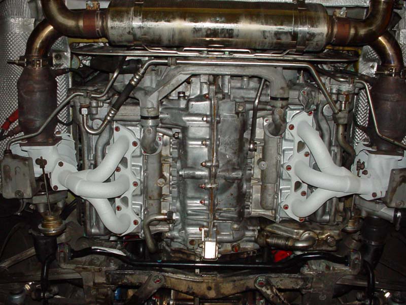

Sweet! Some special sauce coating The one that Kevin used on my turbos and headers is still going strong. No signs of peeling etc... I'm not sure what concussion it is but it works

The coatings were also extended to the headers if you look at the pictures.

Here is the completed picture installed and after the first oil change. I normally run new bearings for a 100 miles then dump the oil and do it again. Before start up I pull the fuse for the fuel pump and crank the motor over until pressure shows on the gauge. This preoils all of the lines. I then will do it again until oil comes out of the drip tanks from the turbos. You must undo the drains for this. This procedure does two things, keeps the bearings from being run dry even for a second. I do use prelube, but why risk it? It also preoils the turbo to ensure good life. Put the fuse in and crank it up and enjoy.

Stephen,
Those headers? I'm not refering to the coating.

Stephen,
We need a close up pic of the injector.
