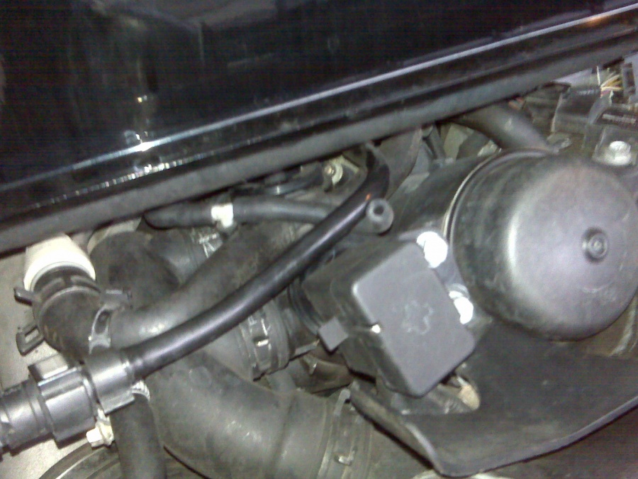

I had my CEL come on about 4 hours after I replaced my MAF with P1411 and P0140 codes. I read every post here and at renntech reguarding these. In trying to track it down I noticed something strange (see pics). Can anyone tell me if/where this needs to go? Would this throw those codes? Would if cause the car to go into limp? TIA

That is one of the top ports to the front diverter valve and it will cause a secondary air injection leak code. You can see the diverter valve in your picture, it is the round black plastic item straight in from the end of the line that is disconnected. If the valves are blown, it will also throw a CEL.

looks like a vacuum line...to the DVs? Oops beat me to it.

Who's been working on your car? There's no way that should have come off there. They just don't rattle loose....did you have an oil change or some work done recently?

I had my car inspected, MAF replaced, 997 shift installed a few days ago. I watched the entire inspection and saw them test these lines. I am guessing they never reconnected this (which is not sitting well with me).
I am assuming this is the cause of the CEL and codes P1411 and P0410(?), correct.

yep happened to me when i gog new dvs, the car was under w then so itook it to the dealer, it was a split hose and the tec sez look some one was took off these stock dv and installed these cheap forge dv they wanted $200.00 to replace the hose because they said the forge valves were substandard and too the car outa w what a laugh . i took the car home and fixed it myself for about 30cents

Thanks again for everyone's help. I think I am back in business. I am chalking this up to an honest mistake. The guy does great work and I understand thinks happen.
