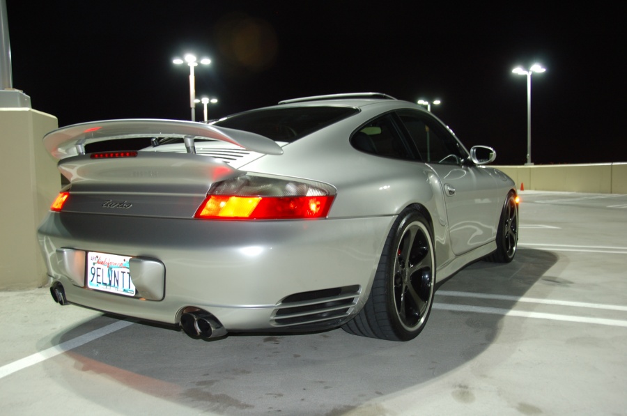

What tail do you have? Looks nice.

Its a TechArt type I wing blade.
