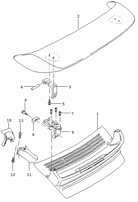

Maybe this will help.

[quote=desert996;2444132]Maybe this will help.
MA Shaw wing is not built that way. Your picture is a Porsche OEM setup.
