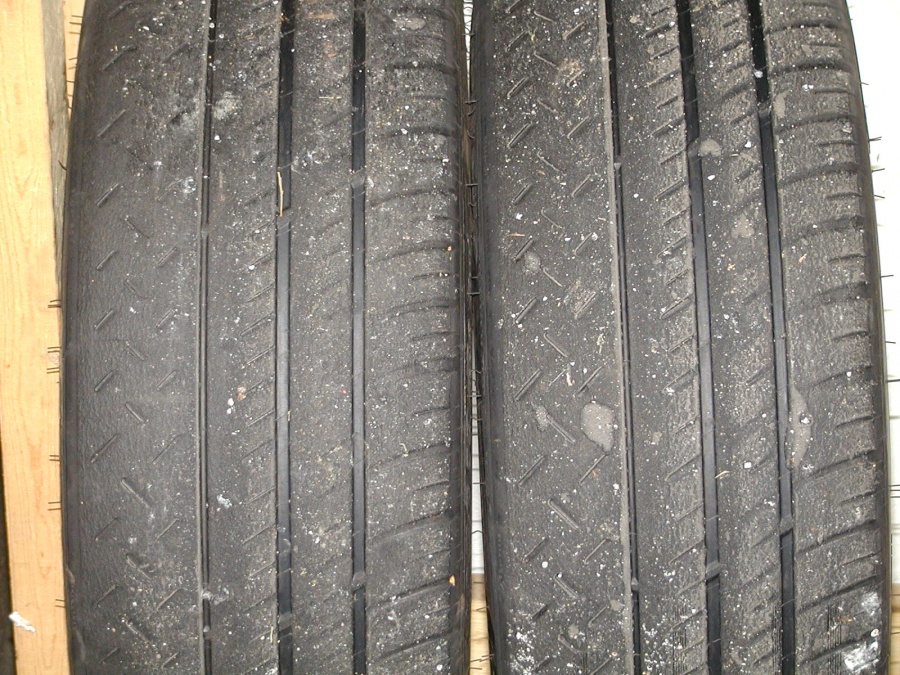

Larry - I think that you will appreciate the photo below. These are my front tires (MPSC) after 11 25-30 minute sessions on a very hot 3-day weekend. Notice how even the wear is! The front alignment was set at -2.5 deg camber and 0 deg toe. YMMV, of course, but one of the reasons the car felt so hooked up, I think, is because I was finally using the whole front tire.
Jon

That does look good. Hope I have the same luck.
Looking forward to the Motons, but kind of not looking forward to having to dial in my car again. Actually, I guess it was never really dialed in, I had just gotten used to it, so it should get much better.
