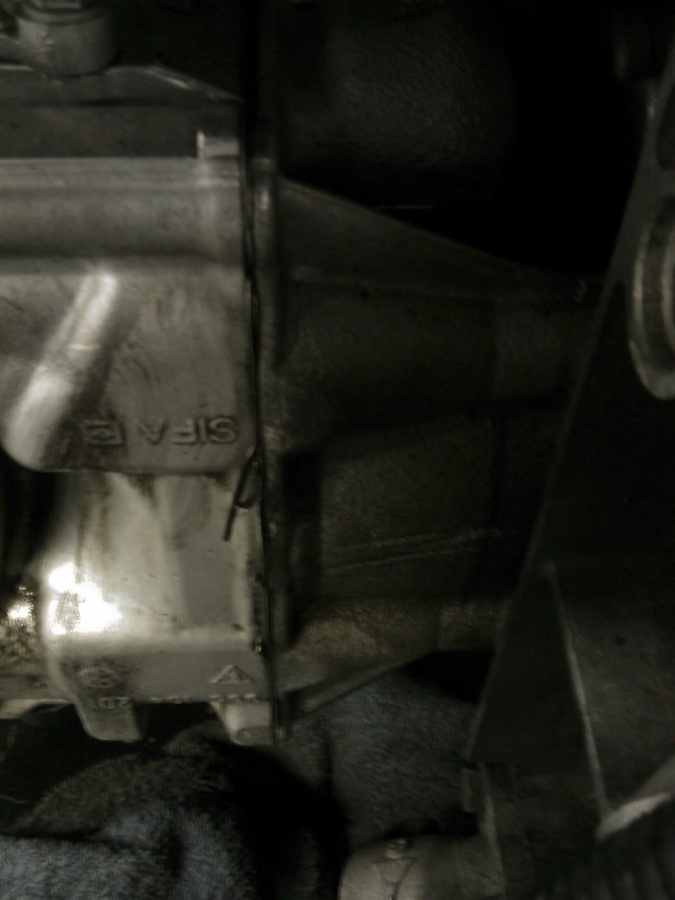

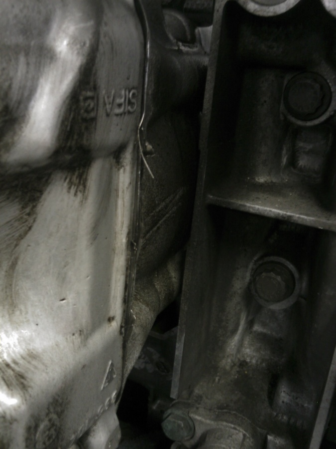

Here are the pics I took today. The HG looks cut up - has anyone ever seen this before?
