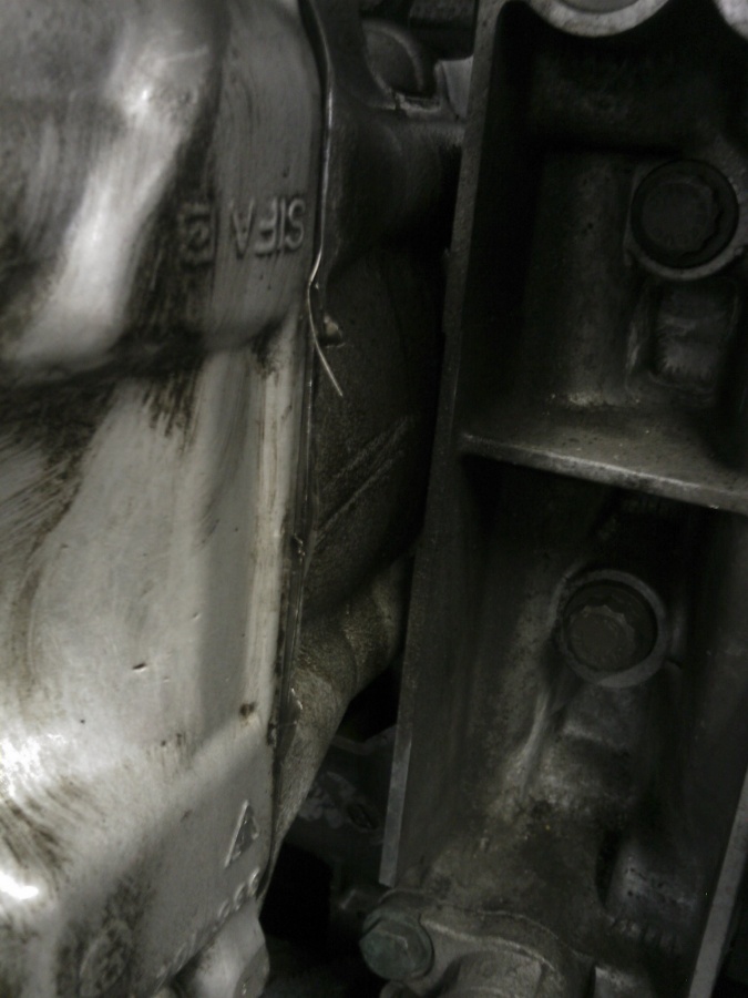

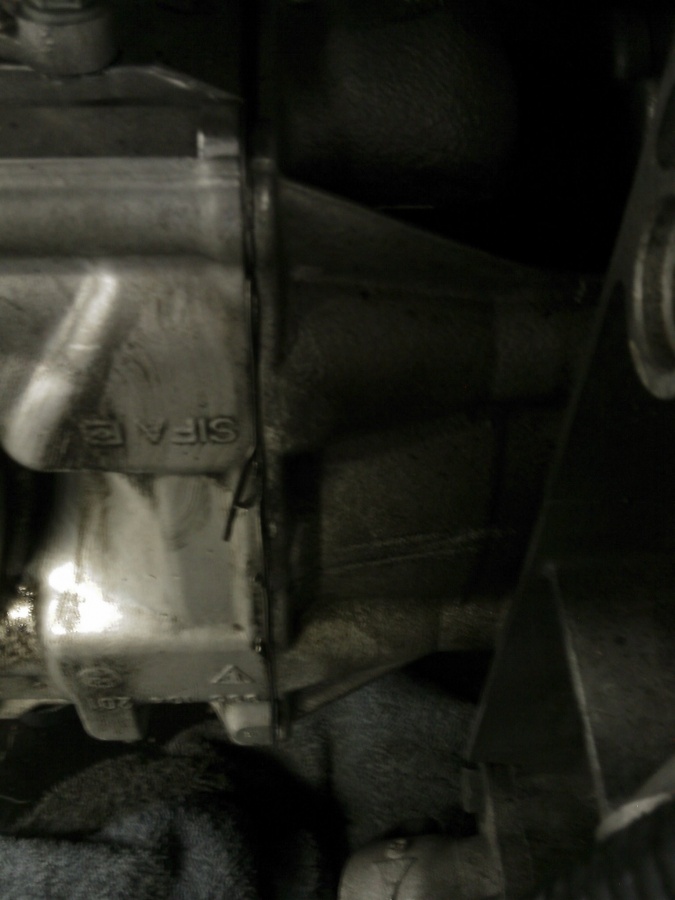

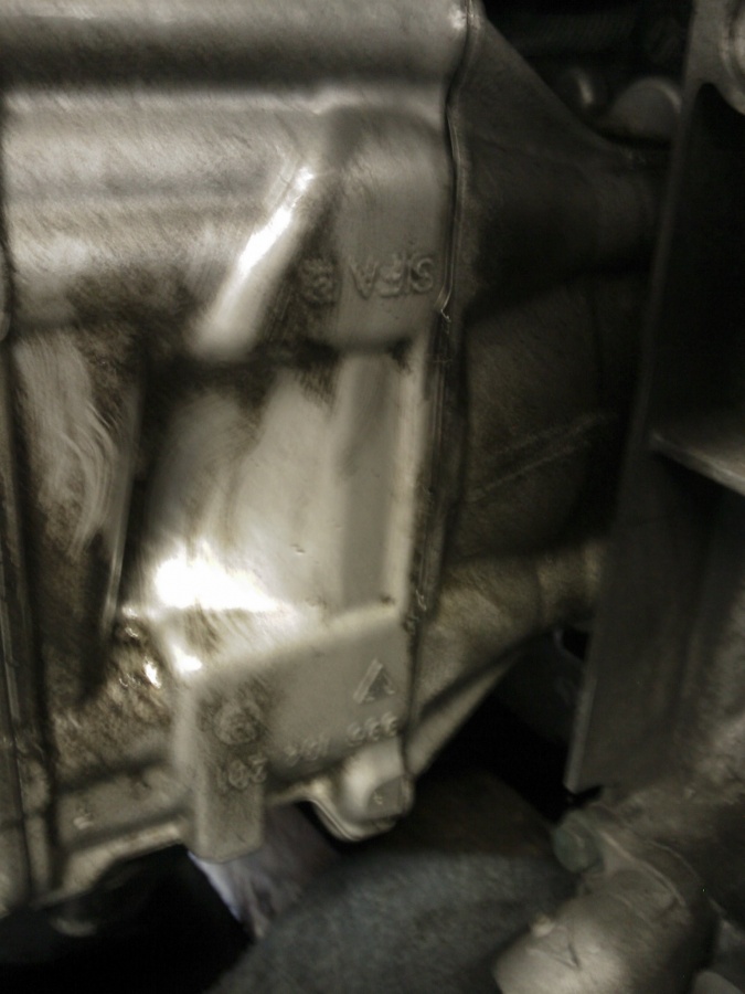

Blown Head Gasket - Anyone Seen Anything Like This
Its cut up and shredded. Anyone seen anything like this?

Jags, I really dont think you can tell whats going on without removing the heads.

Agreed, with my bad eyes LOL I can't detect anything either. I see something sticking out, kind of shredded but not much. Hope you fix her soon. GL
