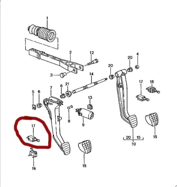

Clutch switch cannot be adjusted but on this picture you can see the location (item #17) . If you don't found anything wrong ( bend bracket or loose switch or mount) just replace it . It is less than $15.00.... Part# 99661311401
