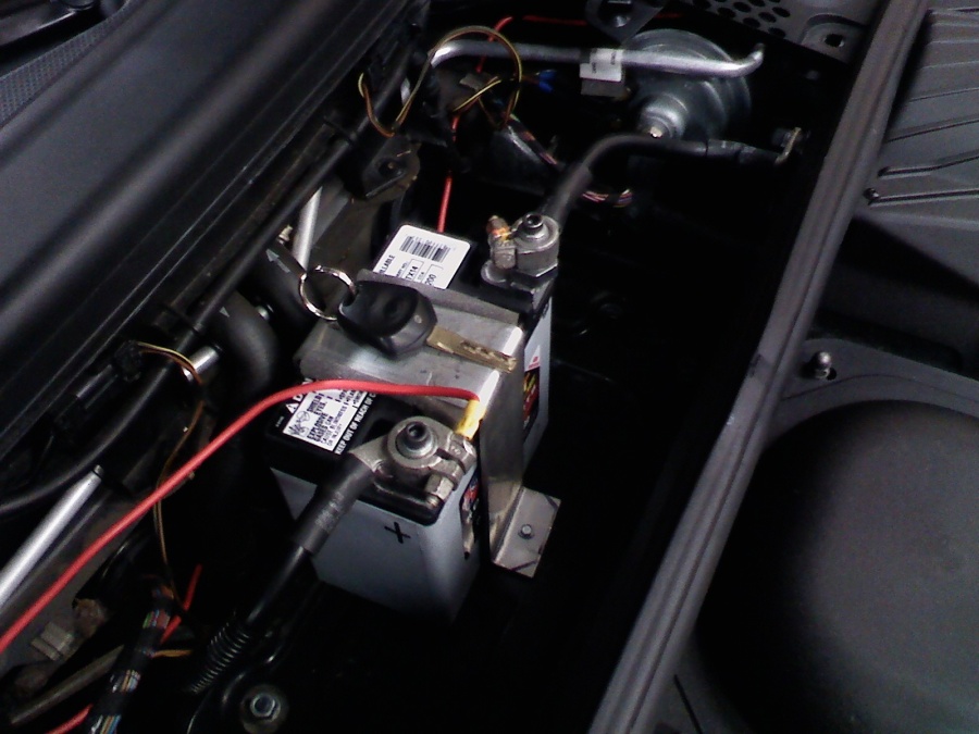

OK, 1st day with the ETX14. The only issue I can see is you HAVE to pay attention to what you are doing and always think about the battery. Sat all day yesterday and all night and had no issues starting, many times. (I always set the alarm!!!)
However, I had to work on the car at the track today and had both doors and rear decklid open for about 30-40 minutes and when I got in the car...click click click...Jumped it and made sure all the doors were closed all the time and never had an issue after that. It's very easy to swap batteries if I need to. If I know I will be going to the track or going out to the highway, I'll leave the little battery in it. If I am not going to be racing, I will leave the stocker in. IMO, well worth the 39lbs I saved.

OK, it's been almost 2 weeks now with dinky LW battery. My car has sat in my basement untouched for almost a whole week now. Started right up, no issues. Everything seems to work fine and haven't had any issues starting and stopping. As I said above, pay attention to when you are working on your car. If you have to work on it for extended periods (more than 20-30minutes) disconnect the battery.

Here's a picture of it in my car. Key is for size reference...
