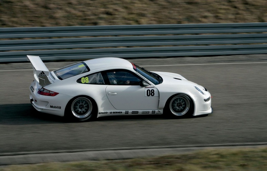

Looking for front wide fender options - front fender replacements that allow a wider wheel rather than full on wide body kit. (Best if new fender mates with factory mudguards and bumper.)
Found a photo of this 997 gt3 cup S. Anyone know if something like this was made for the 996tt?
thanks

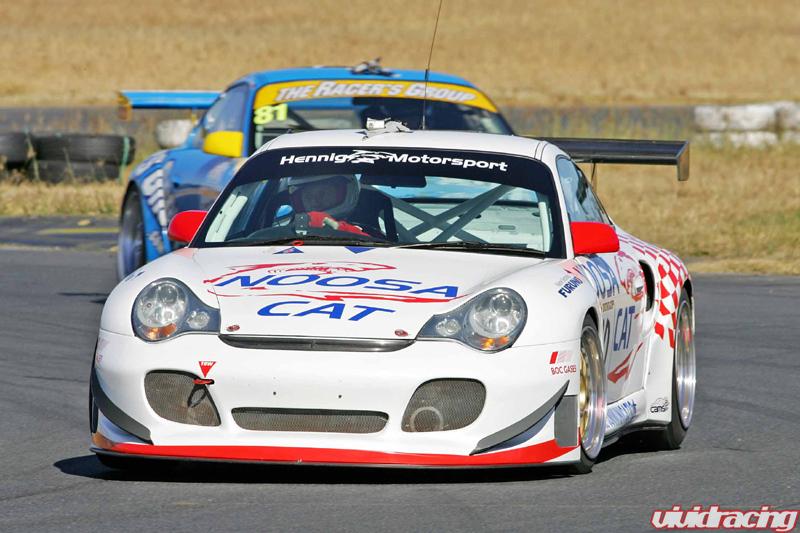

alternatively, would a RSR front end work on a turbo 996?

this front end isn't bad either, but prob custom.

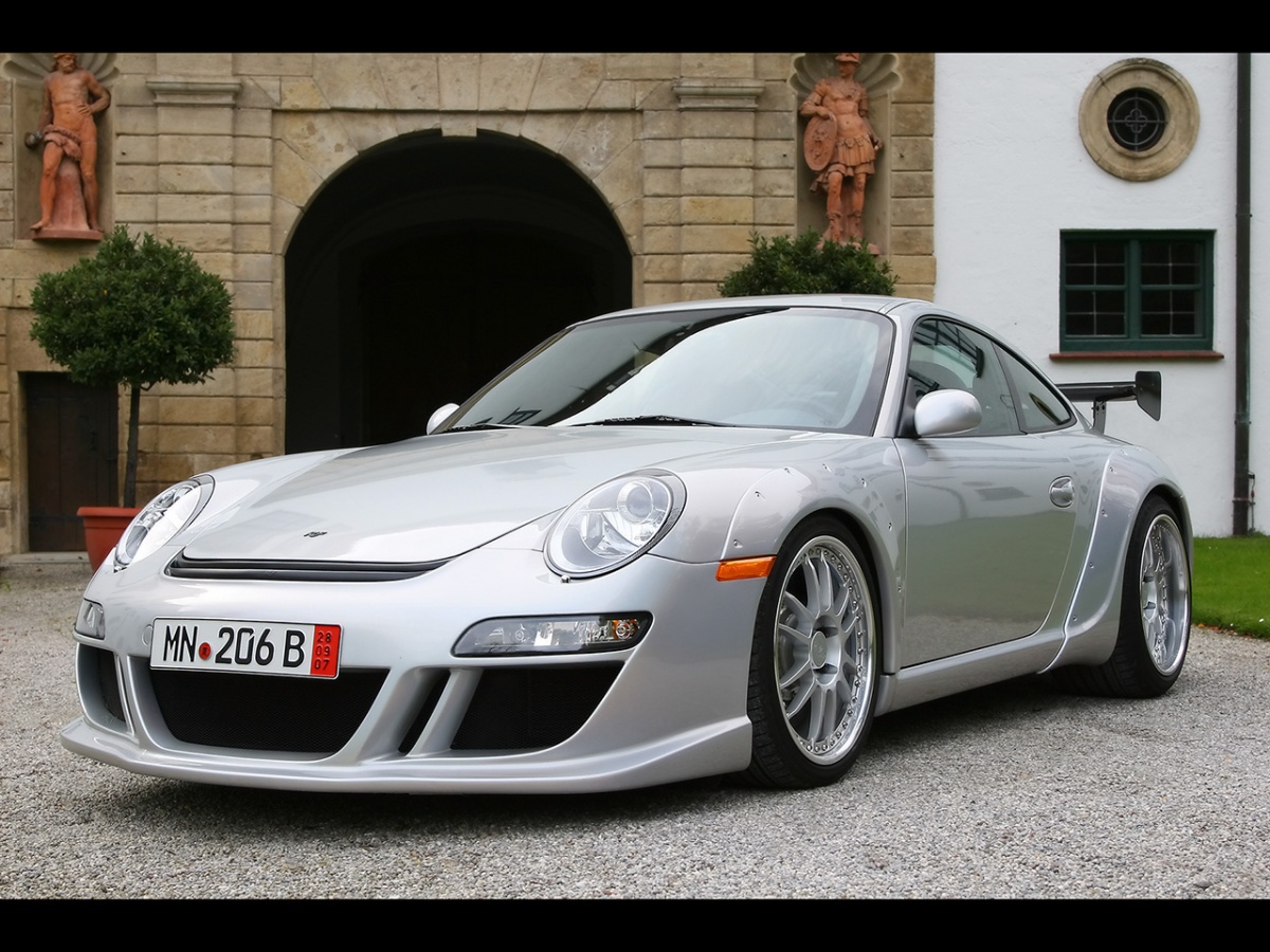

There is this option....
please more info..or is this a generic thing that most reputable shops can do?
