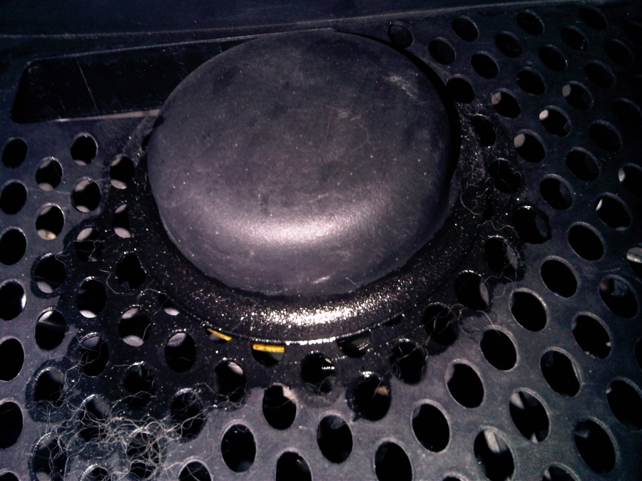

Found this today.
Got a Clutch Masters Stage 3 Full Disk with FiberTough and Clutch masters LWFW in transit.
Looking into doint the evoms slave delete kit but heard it's not compatible with some clutches.
Can anyone confirm this? thank you

I wouldn't drive your car anymore as your slave is really pushing Pentosin bad. I'd spend a little time too and get that mess cleaned up good.
